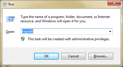

    1. Click the Windows key and "R" at the same time.
    This will open a "run" box.
    (the Windows key is located on the bottom left of your keyboard, between CTRL and ALT)
    2. In the box, type "regedit" (example above) 3. Navigate to
    HKEY_CLASSES_ROOT\AcroExch.Document.11\shell\Print\command 4. I had this as DEFAULT:
    "C:\Program Files\Adobe\Reader 11.0\Reader\AcroRd32.exe" /p /h "%1" 5. Double click on the word DEFAULT, and a box will pop up allowing you to change the entry. 6. REMOVE /h from the line, leaving only:
    "C:\Program Files\Adobe\Reader 11.0\Reader\AcroRd32.exe" /p "%1" 7. Click OK. 8. Exit your registry. 9. Try inserting a pdf file as a printout.*
