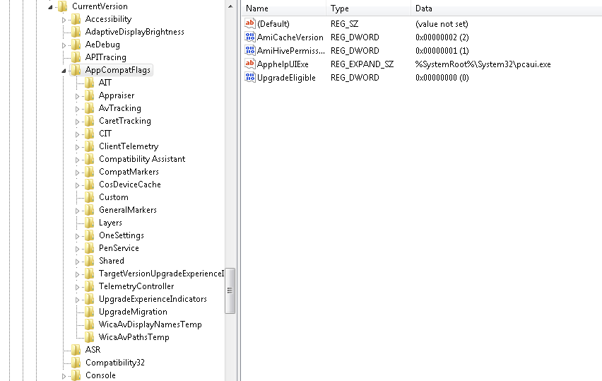

Hi, yeah none of these troubleshooting steps mentioned in your forums seem to fix the issue. I have been trying various options to fix the problem as well but nothing seems to work. The bootstrapper error is persistent.
I tried the registry changes mentioned in several solutions but the options I get are very different from what is mentioned in most cases

Open Registry Editor from the Run window. Press Windows + R keys together to bring up the Run window. Type “regedit.exe” in the Open box and click OK. If prompted by UAC, type your admin password and continue. On Registry Editor window, navigate to HKEY_LOCAL_MACHINE> SOFTWARE> Microsoft> Windows NT> CurrentVersion> AppCompatFlags. Back up this key (AppCompatFlags) and then delete it. Do not delete it without backing up. Now run the Office 2013 installation file again and no such error should occur thereafter.

    2016-08-20T17:12:12+00:00
    I am facing issue of configuring microsoft office-->bootstrapper running and installation files msgs at opening of every word file..everytime i cancel all these and then after 4 to 5 minutes my word file opens...if your solutions also solves my above mentioned issue then kindly answer :
    1- How to Back up this key (AppCompatFlags)
    2- and then how to delete it as it contains many other folders too
    see below please.....
    Thanks in advance
