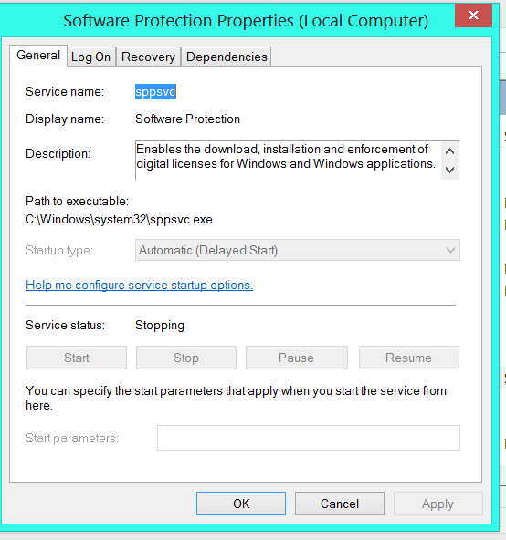

Hi Michael,
My problem was solved after restarting/starting SOFTWARE PROTECTION service in windows 8, that service was stopped and its behaviour was Automatic(Delayed Start). So i just start that service and error gone. YOu try this as well.
800+ people found this answer helpful.

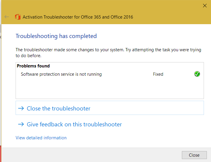

    I've tried for days now to activate my stand-alone version of Word 2016 in Windows 10, which until recently was working fine. Then, for some reason, it wouldn't launch. That led me to many and various ways of uninstalling and reinstalling Word 2016: streaming, download installer, download offline installer. And then trying a quick fix, an online fix, the office activation troubleshooter, and so on. Regardless of what I do, I always end up here when I launch the program and after I go to the website to activate Word:
    When I run the activation troubleshooter, I usually see this:
    But regardless of whatever I do, Word 2016 will always return the first error that it can't find the license.
