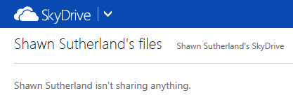

    2013-11-05T22:26:49+00:00
    So Sorry! I'm not very familiar with skydrive yet. I have marked the files as shared now.
    Thanks for the quick response!
    The correct link: https://skydrive.live.com/redir?resid=A79B758FDC35E8D9!315
  3. Doug Robbins - MVP - Office Apps and Services 323.6K Reputation points MVP Volunteer Moderator
    2013-11-05T22:15:26+00:00
    Going to that link returns:
