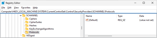

    One cause I found is if TLS 1.3 got configured on the machine. I am working on a Known Issue to document it but sharing here in case it can help. I don't know yet what is setting this regkey.
    1. This issue will occur if your machine was updated to have TLS 1.3 configured.  To workaround the issue do the following:
    2. Click Start, search for Regedit and open the application
    3. Navigate to this path in the registry: Computer\HKEY_LOCAL_MACHINE\SYSTEM\CurrentControlSet\Control\SecurityProviders\SCHANNEL\Protocol
    4. Before you make any change, right click on the Protocols key and Export it for a backup just in case.
    5. If under Protocols you see TLS 1.3 delete that key and its sub keys.
    This is how it should look from my Win11 computer:

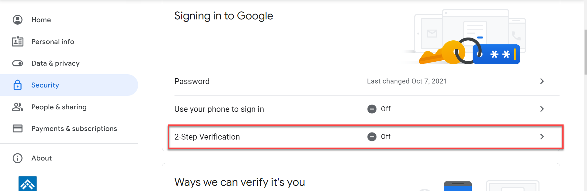

    Unfortunately, I can't answer what you're running into on the Google side of things but you may want to try using a private browser session (or a different browser) to see if that changes anything. If not, you'll need to get a hold of Google support
    FWIW - the attached screenshot that I just took before posting this response, shows what I see on my account

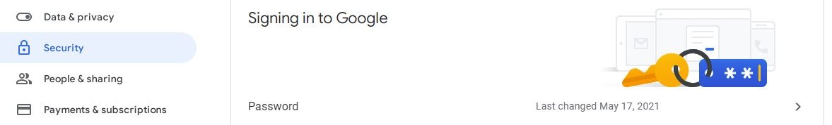

    2022-07-21T20:45:29+00:00
    Waydaminit! That's all I saw with my Google Workspace account, for which I am administrator; I have to figure out how to enable 2-Step Verification with that. However, when signed into my GMail account, I *do* see 2-step verification. I'll work on that account first. Stay tuned, and thanks!

    ...but for (3), I don't see 2-Step Verification as an option under "Signing in to Google". There's simply an option to change my password, which first prompts me for my current password. Am I missing something?
