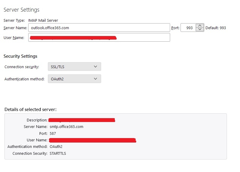

Since yesterday, my Thunderbird client cannot connect to the outlook.office365.com IMAP server and other users at my university are also having this problem. I have deleted the stored token and redone the connection procedure but it does not work. I get two error messages:
The current operation on 'inbox' did not succeed. The mail server for account ... (IMAP) responded: User is authenticated but not connected.
Server outlook.office365.com has disconnected. The server may have gone down or there may be a network problem.
This does not work on any platform: Windows, Linux or Macos. Via the browser, we can access the emails but it is a workaround because it does not support openPGP. We need Thunderbird
