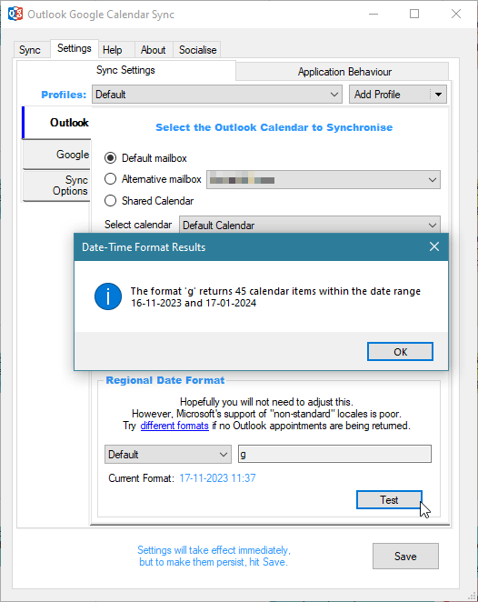

    Whilst configuring and clicking on 'Test' in the settingspanel I got...
    The format g' returns 45 calendar items within the date range
    16-11-2023 and 17-01-2024
    I am sure it is a good tool, a bit too many unexplainable things.

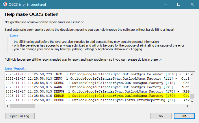

    Hello Mike_884,
    With OGCS, I give permission for 5 minutes (from choice of 1, 5, 10 ...) only once, after each computer reboot.
    As for the error report, I cannot help you at all without more information (the columns with explanations are hidden in your screenshot). The very best solution remains to send said error report to the developer, as advised. My experience is that she/he/they respond quickly and adequately. Do not hesitate.
    See the 'Help' tab in OGCS to see how to communicate with them.
    Cheers,
    H.-P.

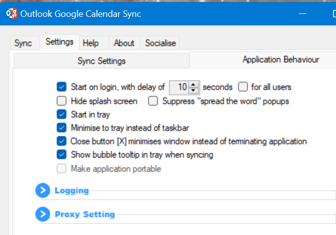

    Hello Jesslyn,
    No need at all, indeed.
    In OGCS, go to the Settings tab, and see that there are two sub-tabs in fact: "Sync Settings" and "Application Behaviour".
    Open the second tab, where the first checkbox parameter is "Start on login". You can even adjust a number of seconds after login to launch the app, to unencumber the login launches sequence (I use 10 s).
    Cheers,
    H.-P.
