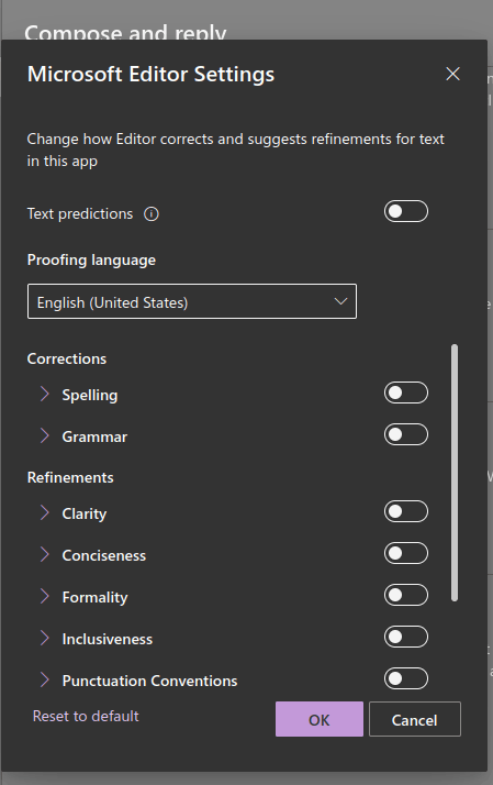

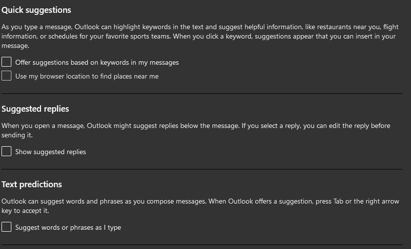

For the moment, while I beg for more patience, you should be able to work around the issue by using a different browser or by turning off "Text predictions". However, as we can all agree, this is not a long-term solution in the slightest. In fact, it's probably not even a medium-term solution, and I sincerely apologize for the inconvenience and problems it has caused.

Thanks for your patience; I've been taking a little time off. I just checked in with the team and we're increasing the rollout for the fix to the full worldwide population today.
In addition, with regards to "turning off keyboard shortcuts doing nothing", the team diagnosed and found that this should be fixed with a refresh of the browser page after turning off keyboard shortcuts.

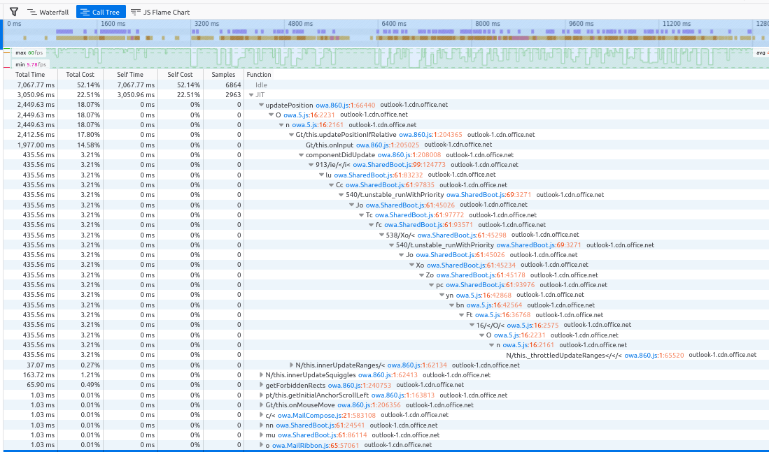

    This has been happening to me for the past ~4 months of firefox releases on linux (ubuntu). The only solution that has worked for me is to literally NOT USE OUTLOOK for sending emails, or type at like 5 WPM
    When I'm typing I'm seeing massive spikes in CPU usage, which corresponds to when the keyboard input doesn't work. Call tree from dev tools below, not sure if this is relevant to the issue, but it looks like input events are consuming way more resources than they have any right to be.
