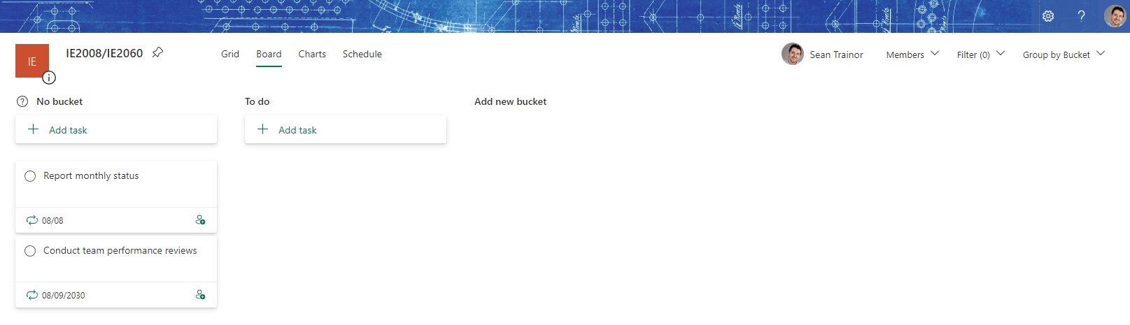

  4. Click the 3 dots at the upper middle of the screen, next to Grid, Board, Charts, Schedule, Timeline.
  5. Click "Plan Settings".

  3. Click the 3 dots at the upper middle of the screen, next to Grid, Board, Charts, Schedule, Timeline.
  4. Click "Plan Settings".

    2024-05-15T09:32:42+00:00
    I don't have the 3 dots you have shown as No. 1. Any idea why mine is different?
