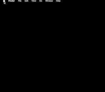

Thanks for the tip! Unfortunately I can't find Low Power Mode. I have Big Sur- will that make a difference?

To enable Low Power Mode, go to System Preferences -> Battery -> Power Adapter -> Low Power Mode
