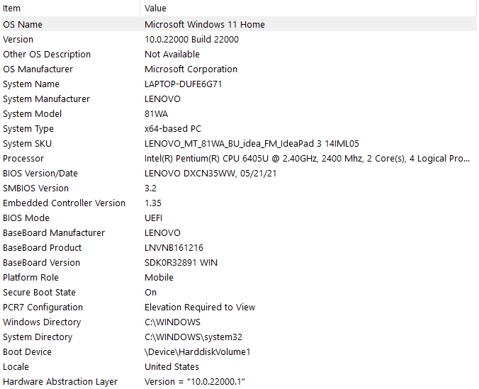

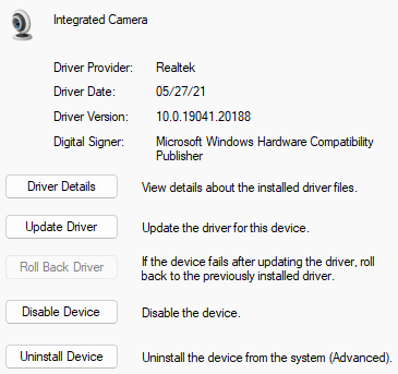

    Another possible cause is the version of the driver, please attach a screenshot of the system information page and the version of the driver installed.
    System information:
    1-Right-click on Start and select Run
    2-Type: msinfo32 and click on Ok
    Driver version:
    1-Right-Click on Start and select device manager
    2-Click to expand the camera
    3-Right-click on the driver and select properties
    4-Then click on the driver tab

    Attaching the requested screenshots. Also, I haven't been able to get my USB cameras to work either, so maybe it's something a bit bigger than just the built-in camera.
    Thanks in advance.
