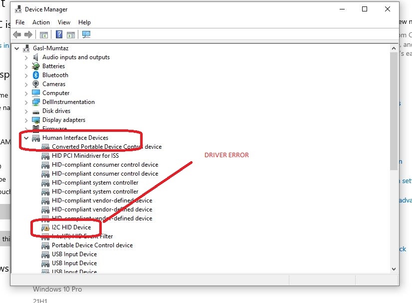

Had this driver randomly fail while reducing the clock speed on my Vostro 14 5410 with throttlestop. Increasing the clock speed back to 100% did not fix the issue. on checking device manager i saw the caution sign on the I2C HID driver. Clicking on the driver, heading to events and clicking on the latest event, I saw this.
Device ACPI\DELL0A7F\4&3091f19e&0 had a problem starting.
Driver Name: hidi2c.inf
Class Guid: {745a17a0-74d3-11d0-b6fe-00a0c90f57da}
Service: hidi2c
Lower Filters:
Upper Filters: mshidkmdf
Problem: 0x0
Problem Status: 0xC00000E5
You might see something similar. As some people have said on other sites, this is due to the driver being unable to restart after being turned off to save power. Which is so stupid that the trackpad is even allowed to go off while the laptop is still one.

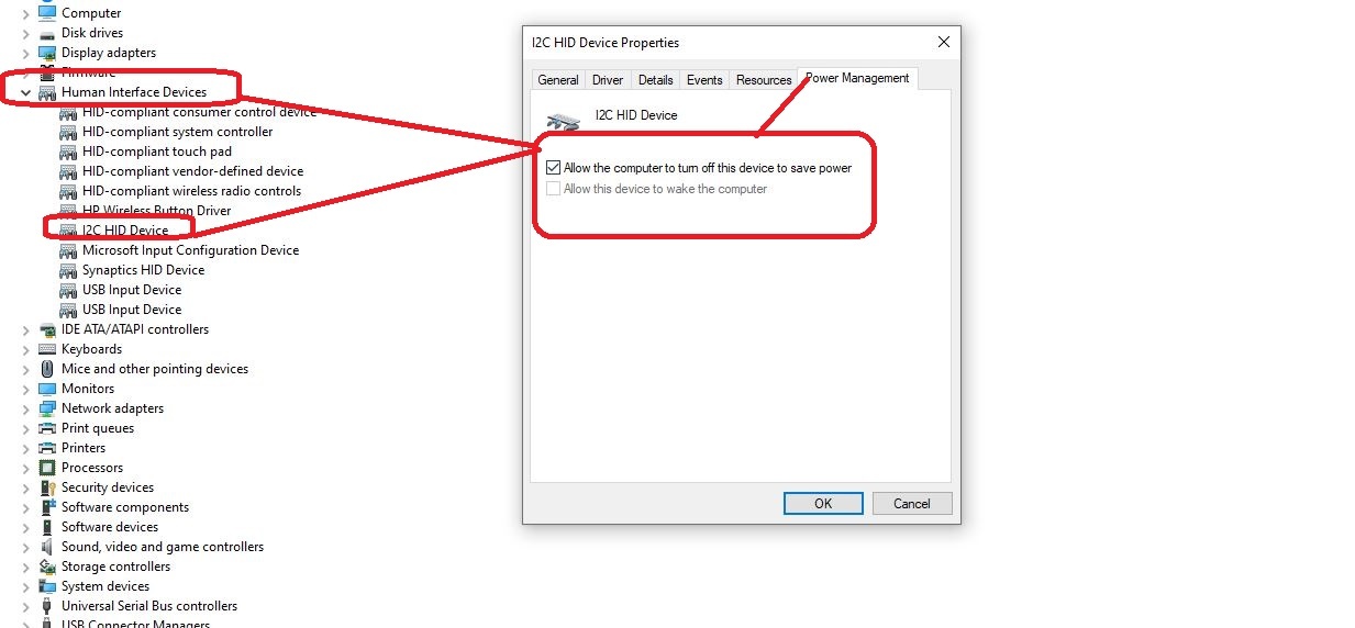

After this mine worked, and yours should work too. While still in Device manager, I opened properties on I2C HID and clicked on the power management tab that only appears if the driver is activeand unchecked "Allow this driver to be turned off to save power" and then restarted. With this I assume the driver will no longer have issues since the system wont randomly turn off the driver in an attempt to save power.
