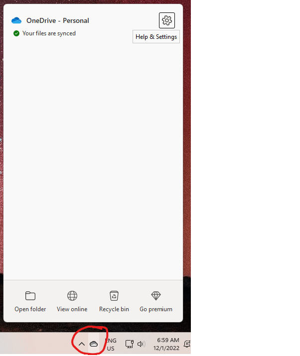

    2022-12-01T01:45:44+00:00
    "REMOVE DESKTOP BACKUP FROM ONEDRIVE"
    This is the right solution, I am on Windows 11.
    Thanks.
