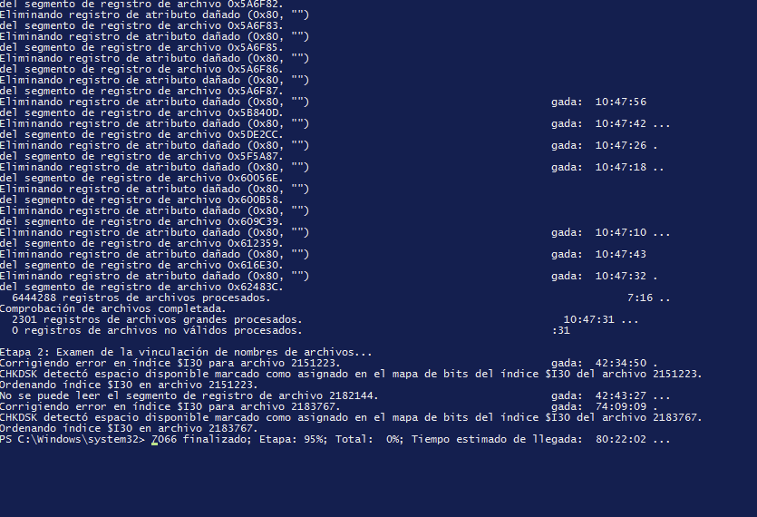

My first problem is that i run powershell with admin rights and ran chkdsk f: /f /r . I thought it would restart pc after that but no, just started running chkdsk until now, so i could access the disk. Now, after about 3 hours total progress is 0%, but in phase 2, is this normal? should i wait? HD is not SSD and with 3.63TB capacity. I made chkdsk previously with CMD and didnt take so long, maybe is slower cause didnt boot windows?

    No, i am completely sure it was with the same partition which was the only one failing, the difference is that this one is with powershell and with no reboot, i can use windows freely and my hard drive is not unmounted, i could access it while it is running chkdsk

    You could risk rebooting then. But, I'd leave it go a couple more hours at least with that kind of thing and see if you see the state increasing.
    Don't know why. Maybe it has an issue since then. Maybe you did it with a different drive and remembering incorrectly? Not sure.
    Adding this in since its relevant to that: https://superuser.com/questions/710516/possible-chkdsk-hang-safe-to-shutdown
    Generally, if the drive light isn't blinking, I'm prone to hitting the reboot button on stuck things at the very least. Its as good as it will get there lol. If it is blinking, its more risky.
    2022-04-15T18:14:30+00:00
    But i did a chkdsk /f /r some days ago with cmd and automatic booting in the same partition and didnt take so long
    2022-04-15T18:10:38+00:00
    /r use can supposedly take a long time as it tries to recover readable information. chkdsk can run right away if the drive meets the requirements to do so.
    /r is slower than a full format because of the recovery. A full format will likely take hours. So chkdsk /r will run even longer.
    If you see the stage increasing then it should still be running. There's about 12 stages or so when I run chkdsk.
    The difference between chkdsk /f /r and full format is that a full format doesn't need to do recovery since everything is destroyed and a full format goes well with a clean install of everything whereas a chkdsk /r may leave issues. The /r can only recover readable information. It fails on anything else. So a chkdsk is longer since you're trying to keep everything but stability isn't as guaranteed as a full format plus clean OS install.
