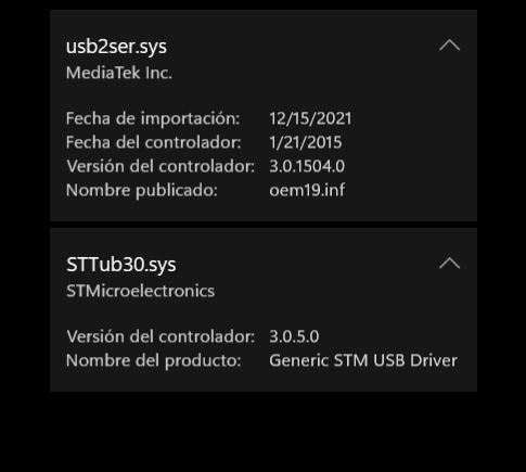

Memory integrity forced off "incompatible driver" STTub30.sys (STmicroelectronics)
Recently my memory integrity has been forced off due to an "incompatible driver" preventing the service from running. The incompatible driver in question is from STmicroelectronics driver "STTub30.sys" In my attempt to fix this, I uninstalled this driver and tried windows update to see if my PC would automatically reinstall this driver but no luck. Now when I turn Memory integrity on and restart my PC (as it prompts me to do so) my computer is stuck on the loading up screen, and I must force shutdown my pc and turn it on again in order to use it. I tried finding the specific driver online from the STmicroelectronics website to manually reinstall it but no luck

2022-09-04T15:13:40+00:00 I have the same issue + usb2ser.sys driver. Both of those drivers are causing my laptop, besides the memory integrity turned off issue, stuttering and lagging. I downloaded a driver identifier but didnt found those drivers, and tried manually with no success. At this point I dont know what else to do and seems that Microsoft support doesnt even care.
2022-12-01T01:36:36+00:00 My attempt to enable the Memory Integrity security feature also failed:
Note that for my system the problem driver was STTub30.sys which was published via oem0.inf. Your details will probably be different so be careful to target the correct driver when uninstalling. Keep in mind that Microsoft does not recommend removing installed drivers. They do recommend that you update them but in my case I don't know where STTub30.sys came from and STmicroelectronics doesn't have an updated driver that I can find and install.
