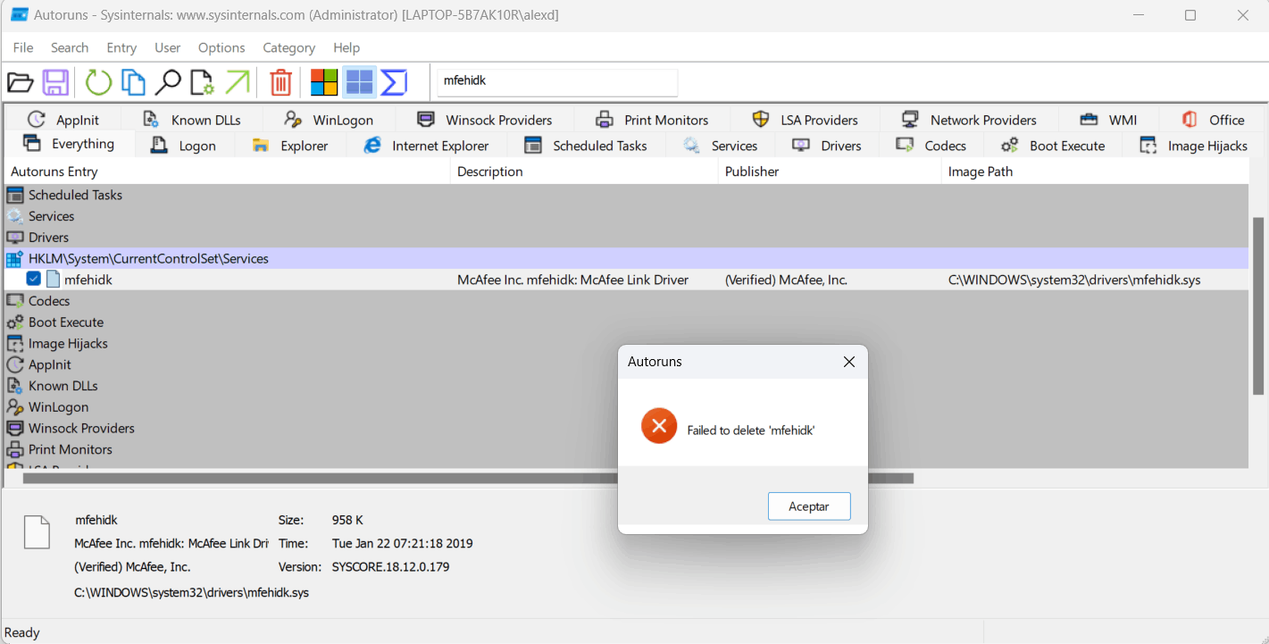

Hi Stephen,
Download Autoruns from the Microsoft Sysinternals site, and run it as administrator.
In the search box in Autoruns, type the driver file name "wdcsam64".
If wdcsam64.sys appears in the list, right-click and choose Delete. Image

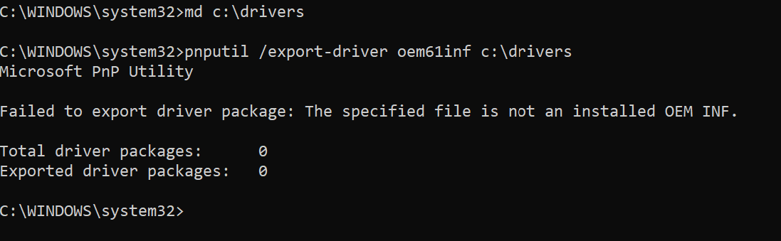

Open Command Prompt as administrator and run this command
dism /online /get-drivers /format:table
Does that list that driver to find the oem*inf attribution

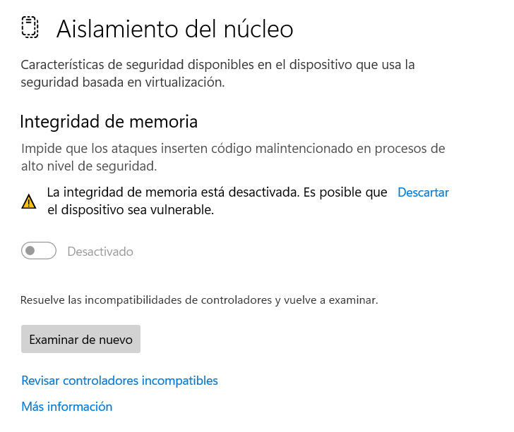

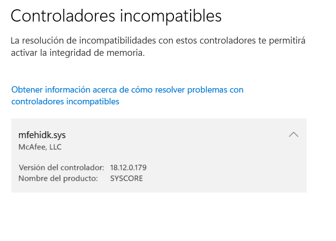

    I have a similar issue to what has been discussed in this forum. I would like to know if you could help me because I cannot solve my case:
    and this is the incompatible driver that I can't remove:
    Trying the options of this forum...:
    Hope you can solve my problem... Thank you in advance.

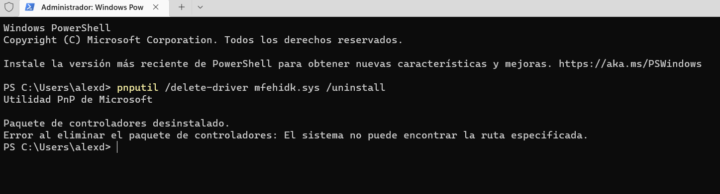

    2022-12-07T15:10:52+00:00
    Hi Ramesh, thank you for your quick reply but that did not work. Below is a photo of what I see on my screen when I type the first two lines. By the way, nothing happens after I type the first line. What am I doing wrong?
