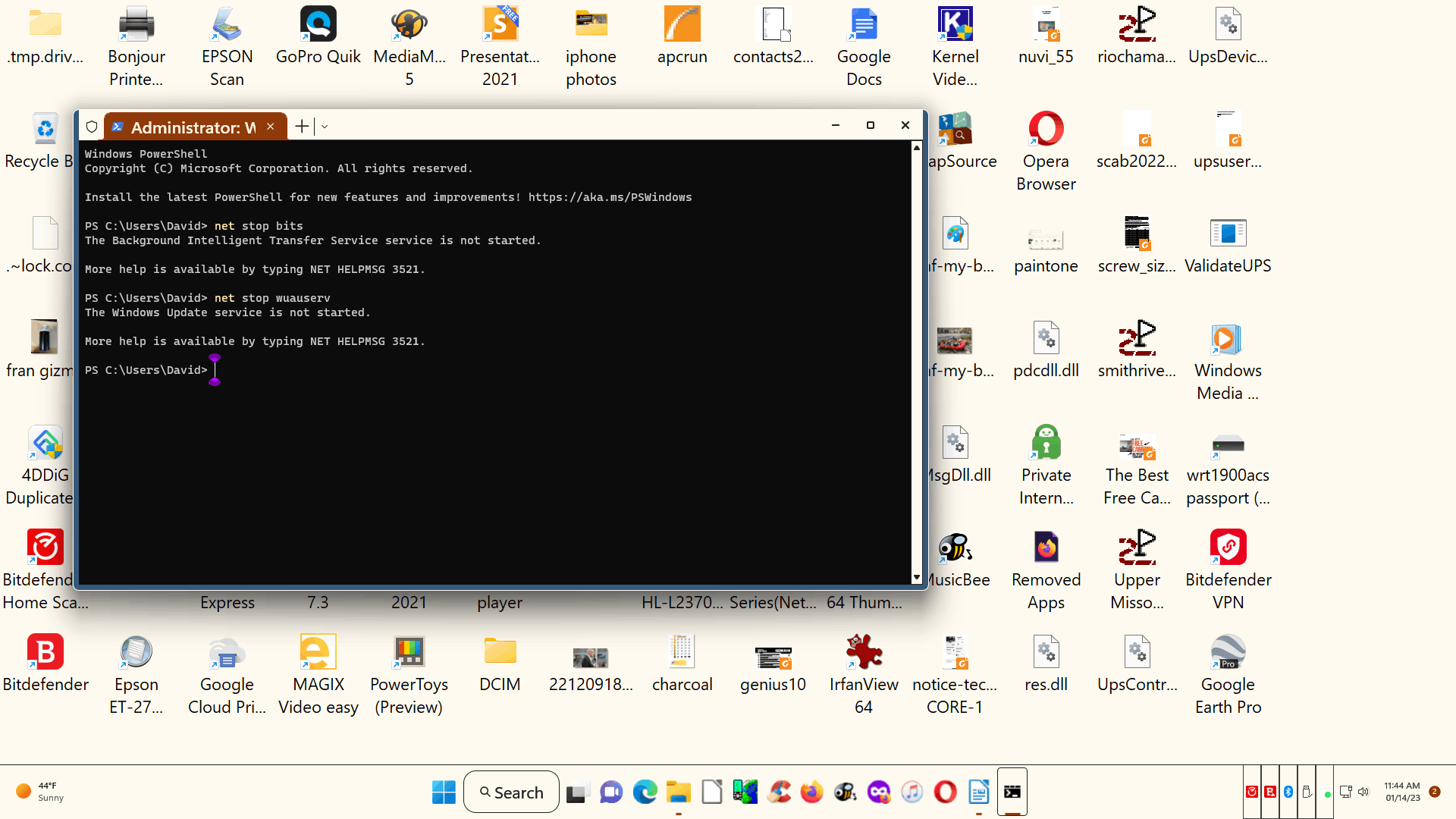

    David M I am a bit nervous entering in commands but did start sat morning.
    I got started with
    net stop bits then net stop wuauserv commands and got the same messages below that they were not started
    Afraid I was getting in the wrong path, I exited out. print screen entered in below
    questions
    should I have continued ?
    or
    should I go to the manual down load you mentioned ?
    just checking is %systemroot% for me c:\users\david\
    appreciate your help as mentioned not that sure of myself entering in direct commands.

  5. David-M 127.1K Reputation points Independent Advisor
    2023-01-13T17:40:18+00:00
    Thanks for the screenshot.
    You can remove it as it contains your email address.
    Always censor personal information or hide it from the screenshot by selecting only the relevant area using the screenshot tool. The Microsoft Community is publicly viewable.
    I suggest doing the following:
    Rename the software distribution folders as instructed below:
    1. Open Start and type cmd, right-click on "Command Prompt", and select "Run as administrator".
    2. Run the following commands at the Command Prompt one at a time:
    net stop bits
    net stop wuauserv
    net stop cryptsvc
    ren %systemroot%\softwaredistribution softwaredistribution.bak
    ren %systemroot%\system32\catroot2 catroot2.bak
    net start bits
    net start wuauserv
    net start cryptsvc
    1. After all these commands are completed, close the Command Prompt window, restart your computer, and then try to update Windows.
    If it persists, download and install the update that is having problems manually.
