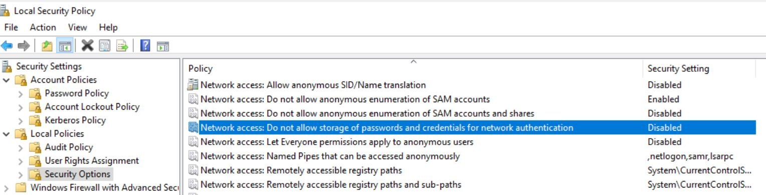

    Under local security policy I disabled the Network Access: Do Not allow Storage of passwords and credentials for network authentication and found teh task scheduler jobs accepted domain accounts.
    Its raising on all 2019 servers after December/January security patch updates its impacts task scheduler jobs running with domain accounts.
