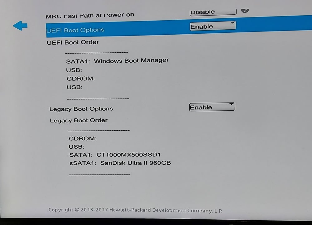

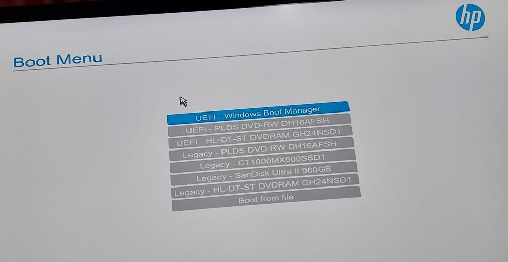

    (3) I can't say I understand your BIOS screens. It does have the UEFI Windows Boot Manager on top at the Boot screen which is good. Beneath it are other UEFI & Legacy options (but not as many as are in the BCD). I guess your BIOS lets both UEFI & Legacy be enabled at once.
    Presuming you can't boot now, go ahead & apply factory defaults. They should be at that setting anyway if you've never altered them. Then try to boot. Good luck.

    That might be a good idea, but first let me look at the stuff you posted especially those BIOS screens. You've got an "ignore changes & exit". Too bad there isn't an option to apply factory defaults without exiting. If there were, you could see what you'd get first & decide whether you want them. Let me look at it a bit. It is good to see {bootmgr} on top in the BCD.

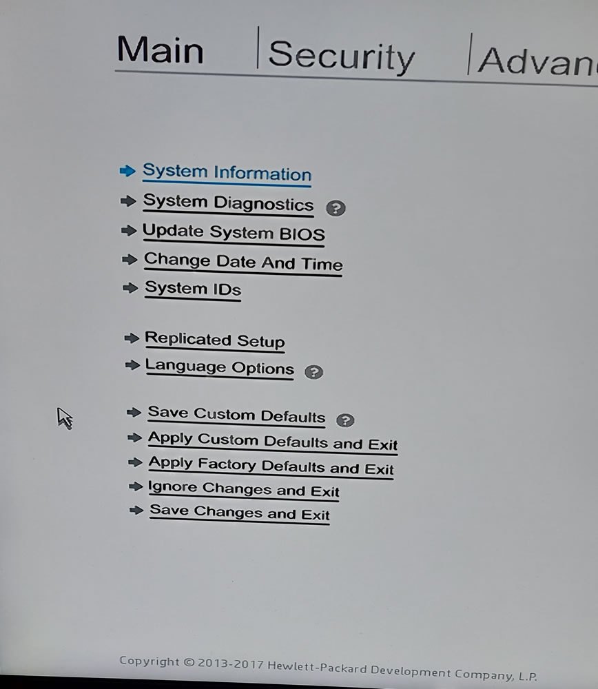

    I am thinking to give up, and connecting D:/ data disk HDD 4TB, and if have Acronis backup of disk 0 -- do a Restore backup to disk 0
    2021-10-27T01:30:33+00:00
    Press apply factory DEFAULTS & Exit [3rd screenshot]...???
