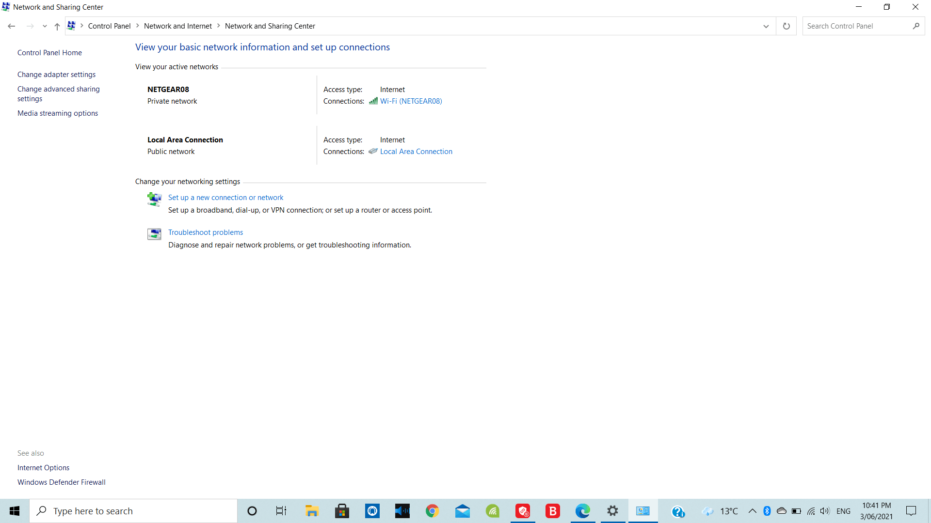

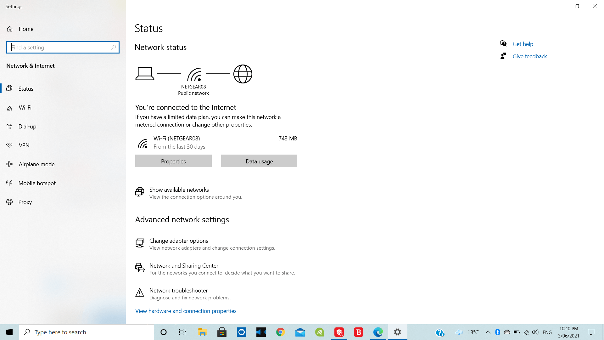

The Wifi icon in the lower bar and it doesn’t matter if its 2.4 or 5Ghz, sometimes it says Local area connection which then is Public, sometimes it says my normal network (netgear) which then is private. When 2.4Ghz is on local network, speed drops and it doesn’t take long to disconnect then. But 5G runs still fast and fine.
I also have sometimes that laptop icon instead of Wifi icon with 5Ghz and I am still connected. When I am disconnected I have that round ball thingy. Laptop is not wired.

    I ll provide pictures as an answer to your picture. I find it really odd and interesting you made me aware. Same network (5G) two descriptions. Same with 2.4. And please see the wifi and laptop icon on the bottom bar.
