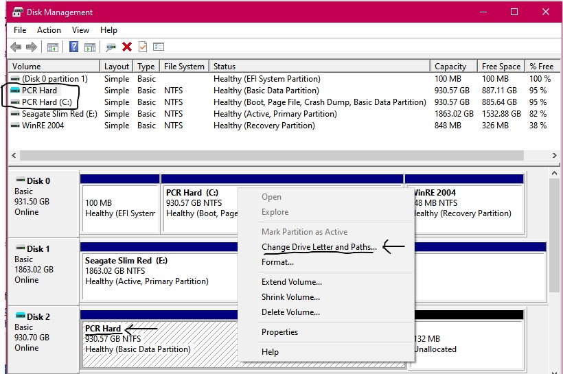

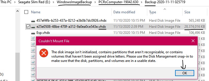

    Well, if you need files off it, you can mount it on one of the other computers & copy the files to USB. Then, do a clean install on the computer that won't boot & copy the files back. It would be interesting just to see whether it will mount. It would probably mean the image is good, & something else is preventing it from restoring.
    (a) Plug in the external drive that holds the image into a good Windows computer.
    (b) Open the WindowsImageBackup folder.
    (c) Open the computername folder that is inside that.
    (d) Open the Backup folder (which has a date as part of its name).
    (e) Right-click the largest .vhdx file in the Backup folder, & select "Mount".
    It might now get a letter (say E) & open automatically in a 2nd instance of File Explorer with the 1st instance still open behind it. Plug in a USB flash drive, & copy your files from the mounted image to it. The files you want are likely in the folders at "E:\ Users&lt;your username>". When done, right-click the E: drive in File Explorer, & select "Eject".
    But, if you get this (or a similar) error message...
    (f) Click OK on the message.
    (g) Right-click START, & select "Disk Management".
    (h) You will see the name C: had on the other computer, but it won't have a letter.
         Right-click it, & select "Change drive letter & paths", & give it a letter.
         Now you may copy files off it onto a USB flash drive. When done, Eject it.
