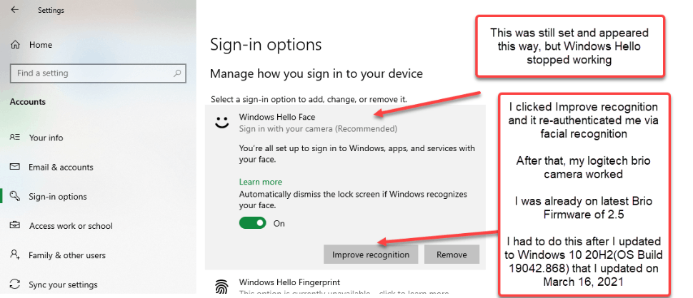

    All, thanks for everyone's help.  I have a Logitech Brio and I was already on the latest firmware 2.5.  Here is how I fixed it after I applied Windows 10 20H2 (OS Build 19042.868) that I updated on March 16, 2021.    Windows Hello gave me the red lights but would not authenticate.  In Windows 10 I went to
    • All Settings
    • Sign-in Options (find it via search)
    • Windows Hello Face (this was still set to On and it claimed I was still configured, by stating this: You're all set up to sign in to Windows, apps, and services with your face
    So in this are I clicked Improved recognition and  Windows Hello showed a grid with my face on it with the camera.  I then exited, and then magically Windows Hello worked again for me.
    Here are some screenshots
