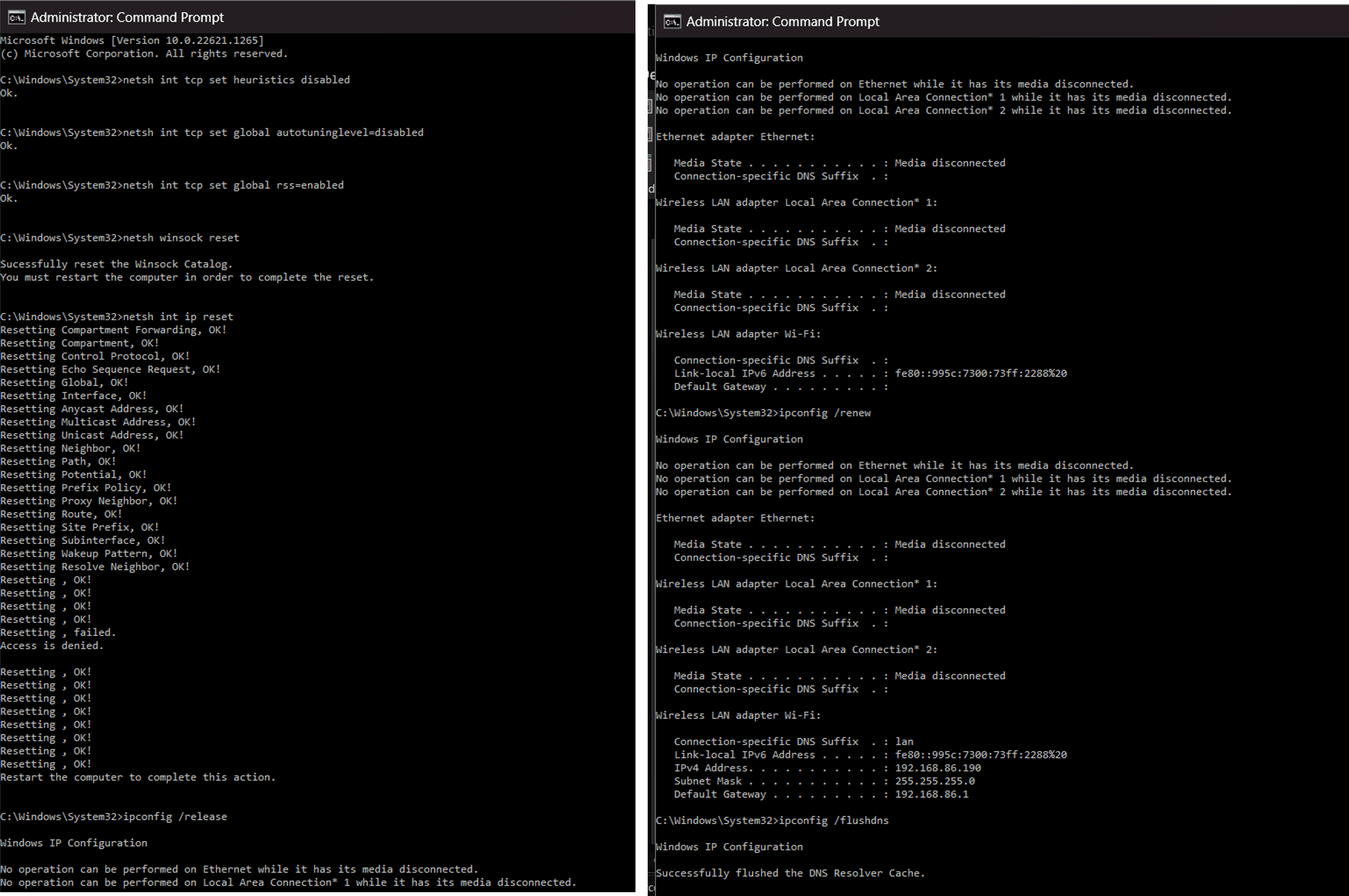

    That did not work unfortunately. To clarify, there are two issues at play, both likely related. 1) My PC network connection is showing as connected to my home network but not connected to the internet, however I can actually access the Internet as I am online accessing websites such as this forum from the same PC. 2) Some apps like Spotify think my PC is offline and will not let me access any content. Guessing it needs more than just reset the MS store cache as after I reset it the store still thinks I am offline also - see attached.

    WLAN Autoconfig was already set to automatic, so stopped and restarted it. WWAN Autoconfig was set to mnanual so switched it to automatic. Restarted the PC. Problem persists. See attached screen cap.
    Ran the command prompts and restarted. Problem persists.
    To clarify a bit more, the only issues seem to be that my network status shows as connected to my home network with no intenet access - see attached icon screen cap. And none of my MS apps will work as they all think I am offline. Everything else works fine and I can access all websites.
