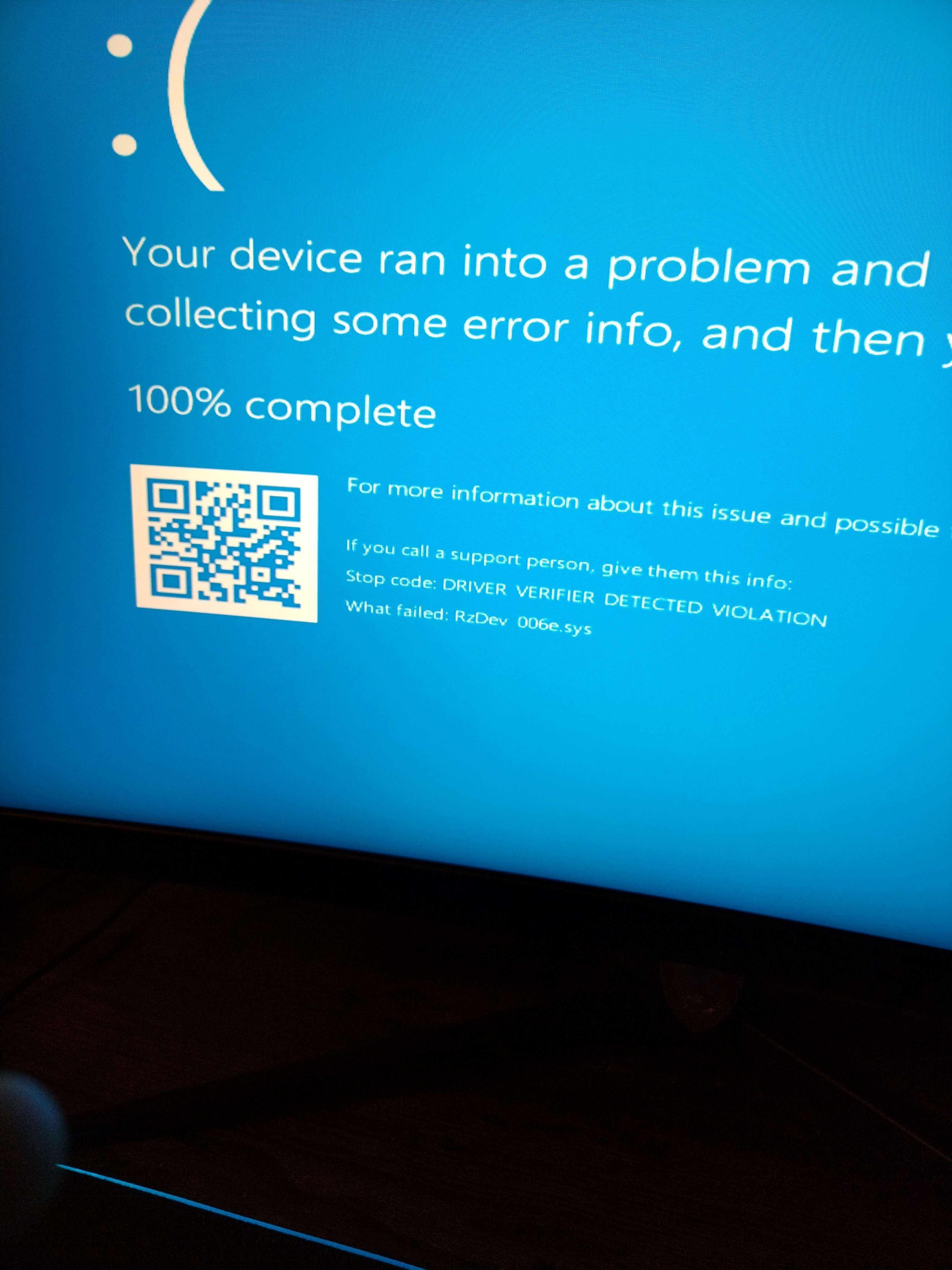

    Ok so I did it I only have one minidump file as it would always crash on start up and my pc forced me to do an automatic repair. Here is the file and also I took a picture of one of the blue screens as it was showing which driver caused the crash while all the other blue screens did not show the driver name.

    I did all that have a picture of the blue screen with the driver causing the issue but now I can't turn on Google chrome on my pc. Please help.

    I do not think you have a hardware problem, I have to log off now, it is very late here, please use the steps below, I will be back first thing in the morning to see how you are getting on.
    To try to force Windows 10 show any faulting drivers, the best option would be to turn on Driver Verifier, let your PC crash 3 times, then you must turn off Driver Verifier, and finally, upload any newly created minidump files
