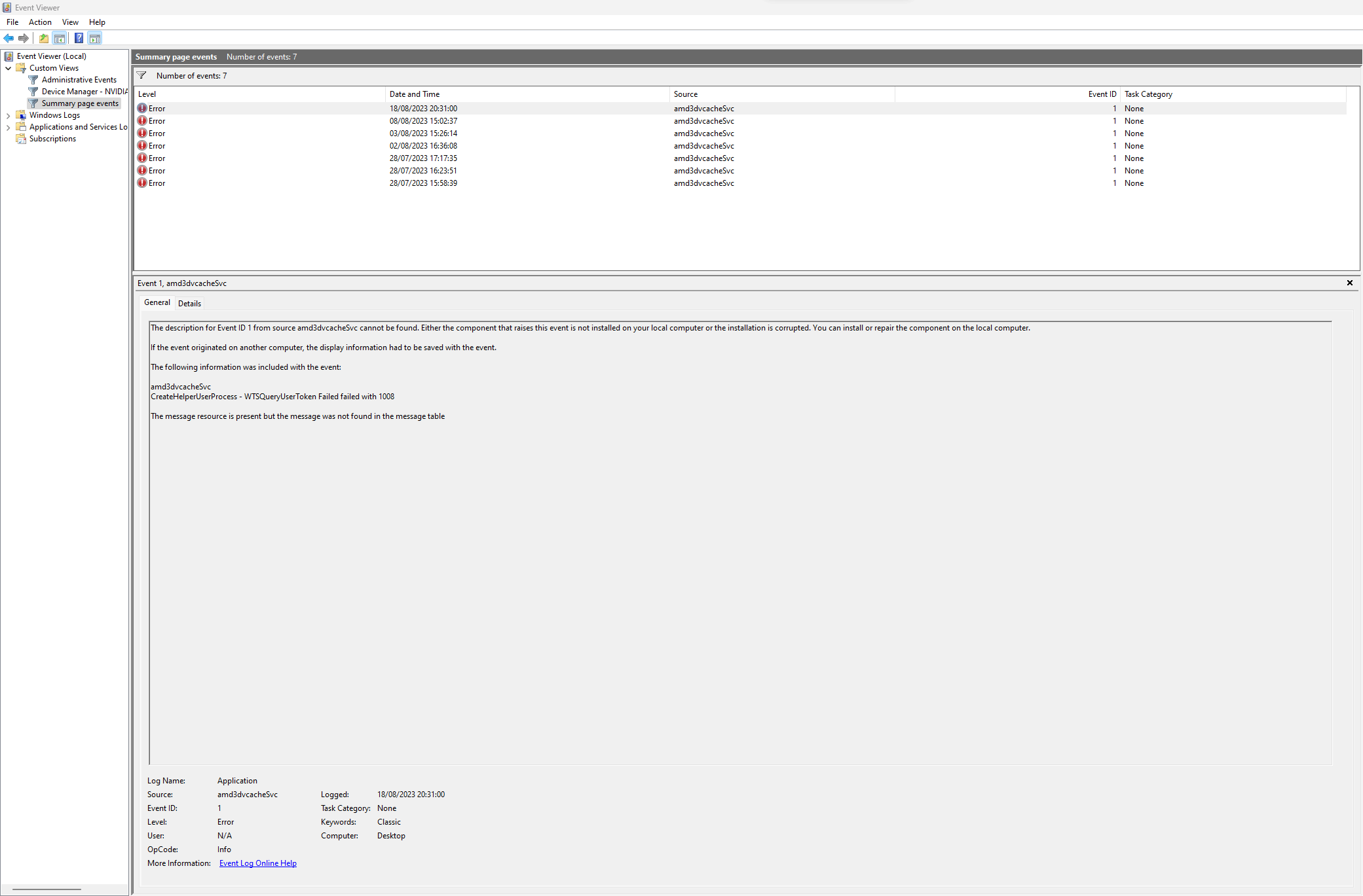

amd3dvcacheSvc is causing errors, help needed
2023-04-14T14:25:32+00:00
The description for Event ID 1 from source amd3dvcacheSvc cannot be found. Either the component that raises this event is not installed on your local computer or the installation is corrupted. You can install or repair the component on the local computer.
If the event originated on another computer, the display information had to be saved with the event.
The following information was included with the event:
amd3dvcacheSvc
CreateHelperUserProcess - WTSQueryUserToken Failed failed with 1008
The message resource is present but the message was not found in the message table
CPU: 7800X3D
GPU: 7900XTX
Windows 10
32G DDR5-6000 CL36
This is a fresh build and I'm looking for some help with a few errors. One of which is the above. Any help would be appreciated.

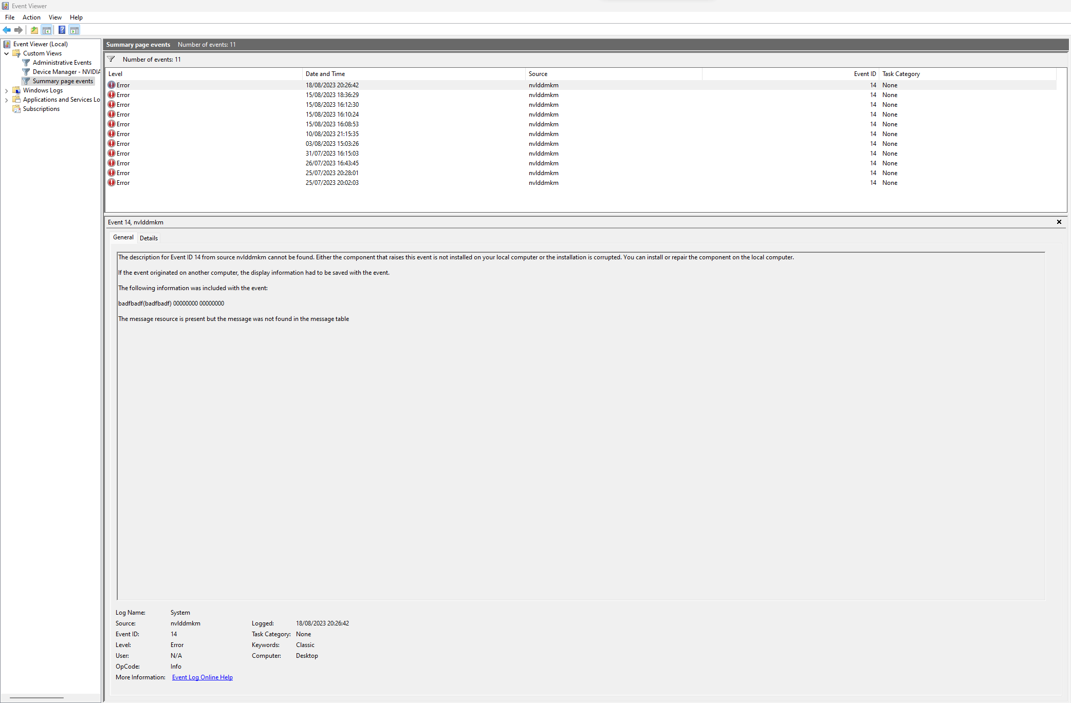

    Hey guys I'm back again,
    I get the same error as you to do with amd3dvcacheSvc but my issue seems to be a bit different to yours. I can play games all day long without any BSOD or system restarts but sometimes on the first cold boot of the day I get this error along with nvlddmkm event ID 0 and event ID 14. When this happens my PC only shows a picture on one of my monitors and my Strix RTX 4090 has a triangle next to it in device manager with an error code 43 which says Windows has detected an issue with the GPU. The system begins to work again normally if I simply restart the PC but every so often I am faced with this cold boot issue. I have also been getting another issue with the High Definition Audio Controller on my X670E Hero board. Whenever I install the NVIDIA High Definition Audio with the graphics drivers my system becomes unstable (system freezes, high DPC and ISR counts causing system latency and BSOD's due to DPC_Watchdog_Violation) after saving and exiting the bios screen. If I install the MSI Utility V3 from TechPowerUp and set the GPU to MSI supported then this issue goes away until I update my graphics drivers again. It's almost as if the GPU and the onboard audio of the motherboard are fighting one another which isn't normal. Honestly, I have never had so many issues with PC components in my life. I have tried nuking my NVME's and reinstalling Windows 11 again countless times as well as reinstalling multiple different NVIDIA drivers after using DDU in safe mode. I have tried reinstalling the chipset drivers multiple times as well as updating the BIOS. I am beginning to think that the GPU and the motherboard may both be faulty as nearly everything in the system is new. The strange thing is, I can sit and play games for hours on end with no issues. I thought it was an issue with the GPU when in idle state but I set the GPU to prefer maximum performance in NVCP so it never idle's below its boost clock but it didn't make a difference. I have also removed C states from the CPU in BIOS as well as set system to High Performance power plan and removed any power efficiency settings. I have also turned off fast startup in Windows and Fast Boot in BIOS. I don't want to have to RMA and wait up to a month for a replacement or have them turn around and say there's nothing wrong when there clearly is. I forgot to mention that the computer also freezes with BSOD when I put the system to sleep and try to wake it up again; the monitors take forever to turn back on and when one of them does, it just goes off again instantly and the system becomes unresponsive. Also for anyone that has a random system restart, you can go into advanced system settings on Windows and disable automatic restart. This will allow you to read the BSOD you're getting and will allow the system to record a memory dump of what exactly is causing the BSOD. You can then download 'Who Crashed' from 'Resplendence' to analyze this BSOD and it will give you an idea of what is causing it.
