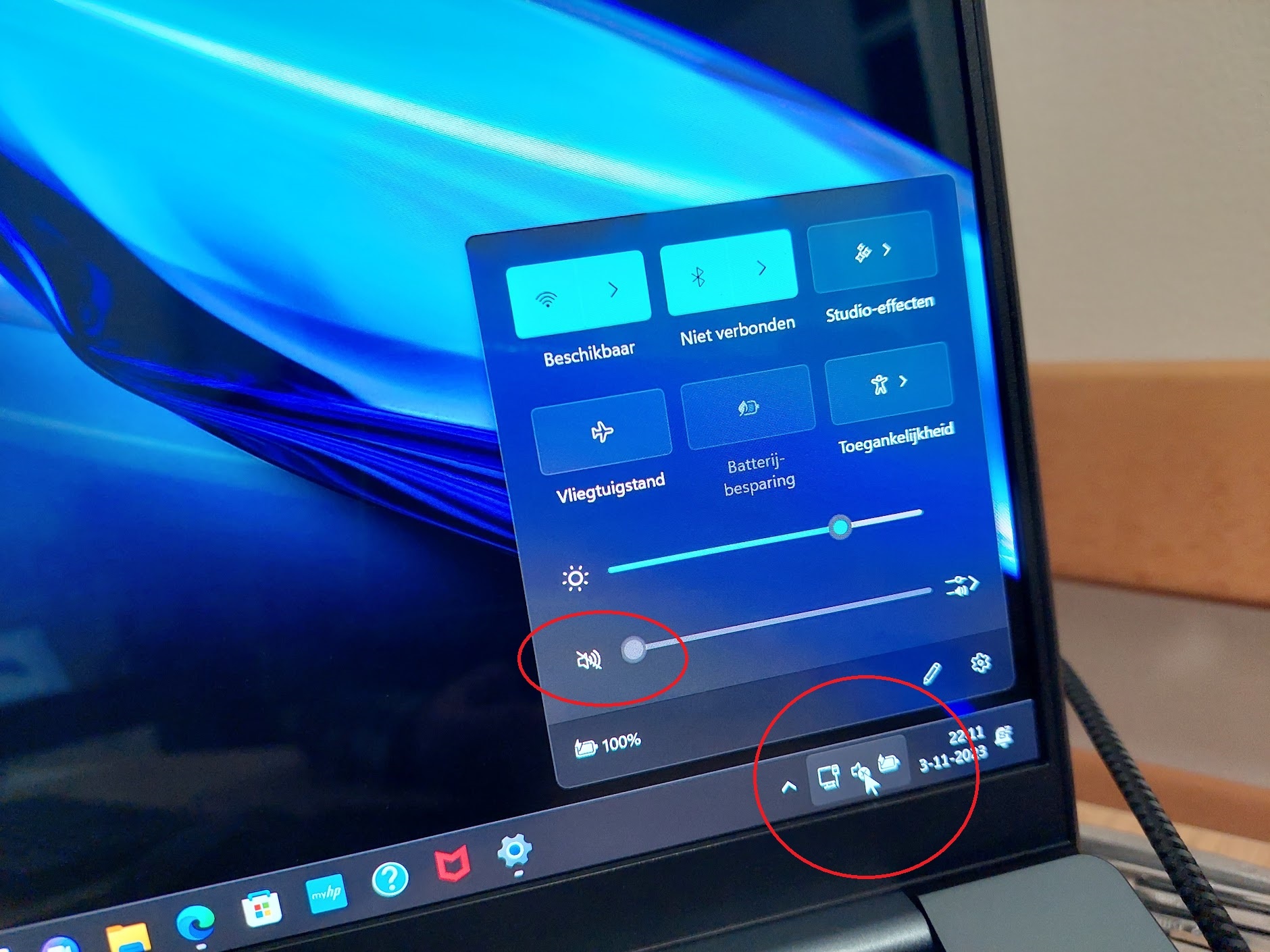

Hello everyone,
Each time I plug my webcam, all audio gets disabled on Windows 11. I had a Logitech C920 and bought a Creative LiveCam to see if the problem would persist and it does, so it must be Windows related.
The only fix for now is to go under device manager, scroll down to "Sound, video and game controllers" disable device there and wait for 30 seconds or so. The issue is that it also disables the built-in webcam microphone, which can then not be used anymore for my Teams calls.
This is a major issue for me as I use this for work. I hope Windows can find a solution to this issue.

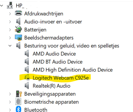

    Another solution that is way easier:
    With your webcam plugged in, go to Device Manager, "Sound, Video and Game Controllers," right click YOUR device (e.g. "HD Pro Webcam C920", or whatever the name of your device is), THEN right click that and click Disable. It didn't work right away, but after about 30 seconds the sound came back on.
    Thanks Felix,
    This worked well, also after a reboot.
    2023-11-30T21:58:30+00:00
    2023-11-10T19:44:13+00:00
    Hi the instruction at the start seems to work. Thanks for that. an alternative soltion can be found by just disabling the audio but you lose the webcam mic. (first i didnt realize since my laptops mic was used hehe)
    (Half baked) SOLUTION: Just disable the webcam under audio and gaming devices. (disable not remove) https://www.reddit.com/r/LogitechG/comments/15403ku/whenever_i_plug_in_my_webcam_it_disables_all/
    "with your webcam plugged in, go to Device Manager, "Sound, Video and Game Controllers," right click YOUR device (in their case "1080P Pro Stream", in my case "Logitech C920 Webcam", whatever the name of your device is), THEN right click that and click Disable.
    It didn't work right away, but after about 30 seconds the sound came back on. I double checked my output in Skype and everything there is in order. I've also waited a few minutes to be sure it worked, as other attempts to fix this worked temporarily and then failed. Thanks, swiftgun107!"
    Update: This Fix will disable the microphone function of the camera as well unfortunately.
