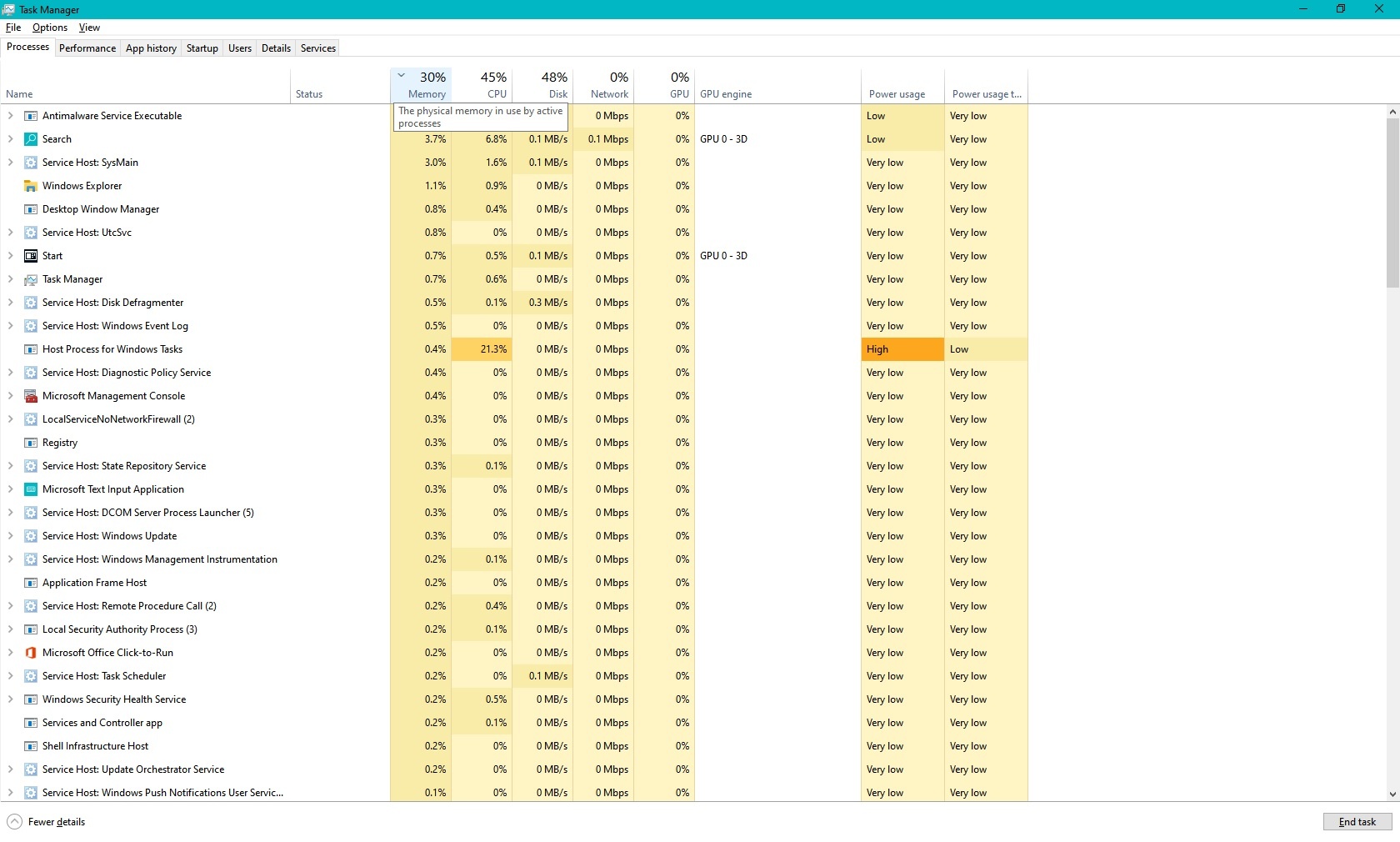

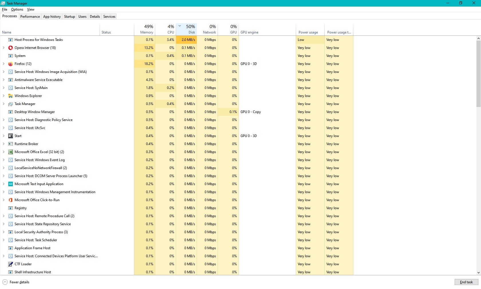

    2023-12-05T11:04:51+00:00
    I found the drain, but I am not sure what I can do about it, any ideas?
    Could you please explain in what way that instance of svchost is "the drain"?
    The Disk usage in task manager showed 50% while this was running when the PC was idle, or in use, and slows everything down massively. There has been a marked slow down over the past few weeks, and even with a clean install, I still get these problems. Initially it was with defrag constantly running, now it is Host Process For Windows Tasks.
    As sysinternals process explorer shows the path as leading to SysMain, I assume this is a windows bug of some sort.
    Even with administrator access, I cannot change the triggers for the process tasks, to stop tasks running constantly. I have run Scandisk, Dism, Autoruns64, etc., but windows just ran something else whenever I managed to disable defrag.
