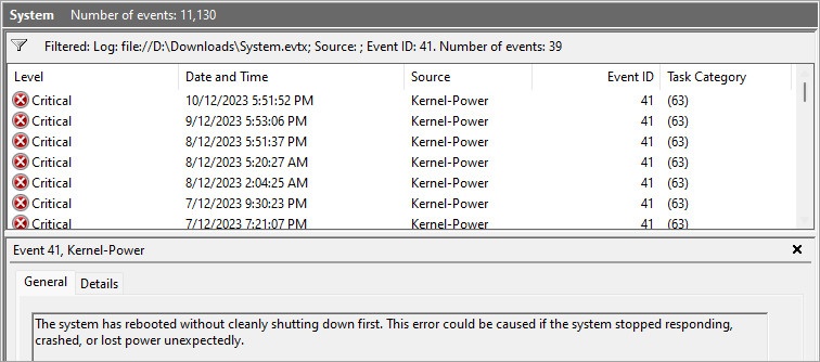

I'm referring to how your computer is crashing and has to be restarted, usually multiple times a day. It's either you or someone is force restarting by switching off the power or pressing the reset button, or the power supply is faulty.

    Is there a method for checking PSU's?
    I guess with a multimeter though exactly how I'm not sure. Swapping in a known good and adequately powerful PSU would work, though not practical if you don't already have one.
    2023-12-12T07:36:51+00:00
    That would tie up with the symptoms. I will check the connectors again, they could be loose. Is there a method for checking PSU's?

  4. _AW_ 69,496 Reputation points Volunteer Moderator
    2023-12-10T22:01:19+00:00
    Under what circumstances is the computer losing power and crashing?
