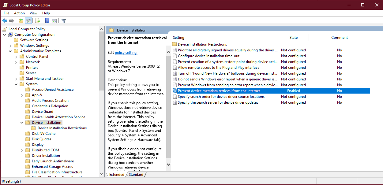

    2024-08-13T19:50:21+00:00
    This is caused by a faulty policy in the GPE.
    Here’s how you can access the Group Policy Editor:
    1. Open the Group Policy Editor:
      Press Win + R to open the Run dialog box.
      Type gpedit.msc and press Enter.
    2. Navigate to:
      Computer Configuration > Administrative Templates > System > Device Installation > [ Setting] Prevent device metadata retrieval from the internet set it as Enabled
    In this section, you can find and configure policies related to device metadata retrieval and other device installation settings.

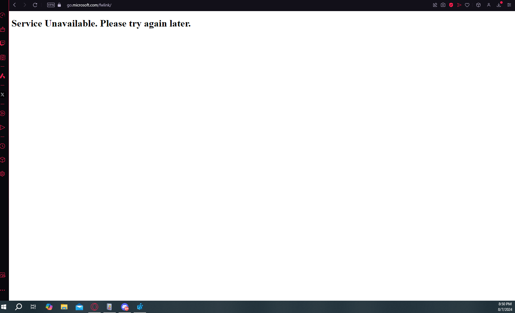

    2024-08-08T10:07:23+00:00
    Hi Jordan,
    Subnautica? no ideas sorry, doubt its related but looks like not only the GPU/CPU got hot so did your sub ;)
    yep that is the expected response from the web URL and why I suspect everyone is getting the 131 Error message. Nothing you can do my friend suspect only Microsoft knows what they broke and if and when they are going to fix it. More often than not they simply ask you to ignore what's broken saying it is not vital etc.

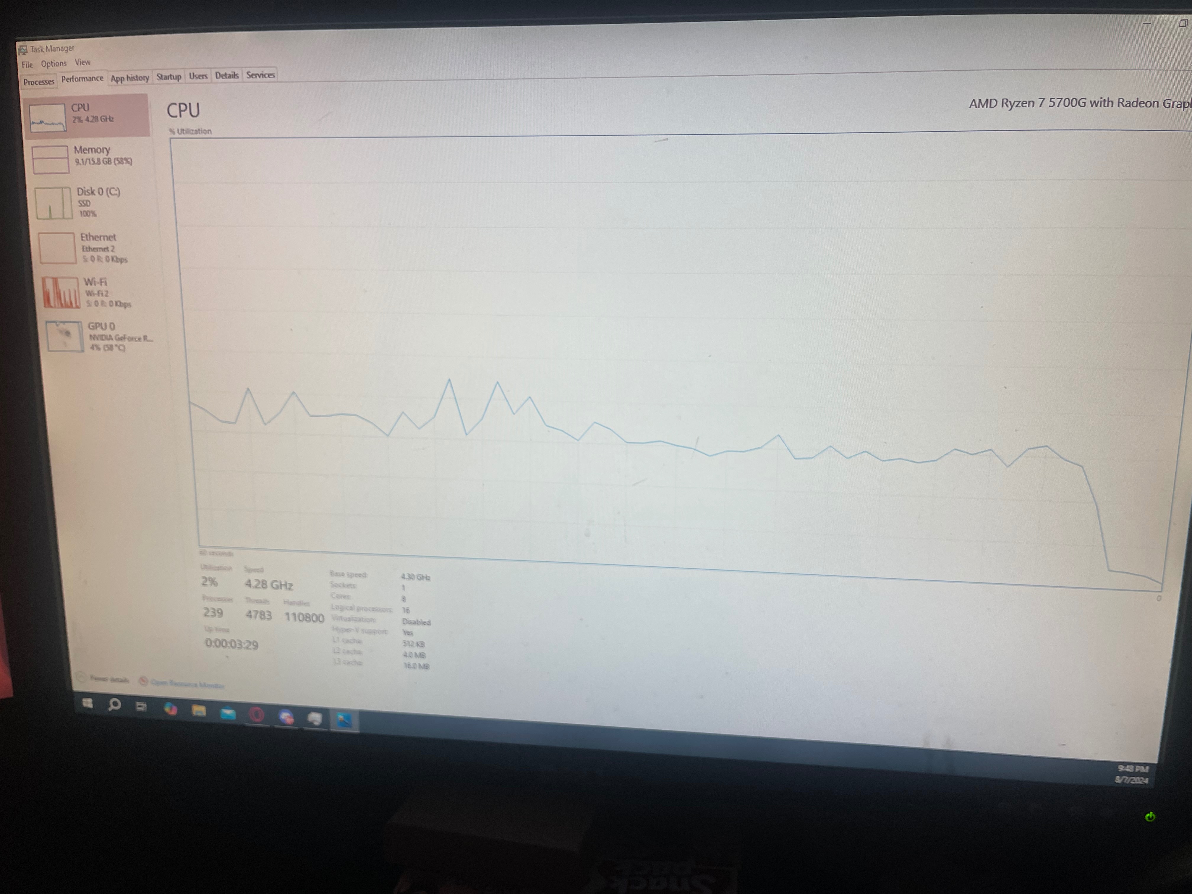

    2024-08-08T01:51:49+00:00
    this is what i got
    The two other photos are of when i was playing subnautica on max settings the gpu got up to 100% and then the cpu and gpu dropped to low percentages
