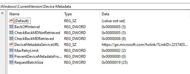

    Okay, I reluctantly completed the steps you posted, and it seems to have worked. I haven't gotten an error 131 in about twelve hours. I'm confident that did it.
    On one hand, I'm relieved; hundreds of error messages a day is no joke. On the other hand, how am I going to receive driver updates for that so it's permanently fixed? I just turned them off. Are there apps/programs that notify me when these are available for manual download? Or should I just go 'low-tech' and schedule a recurring event in my phone's calendar to check manually (which seems like a hassle)? There is no way I'm going to just remember to do this later without some kind of reminder.
    Thanks BigT.
