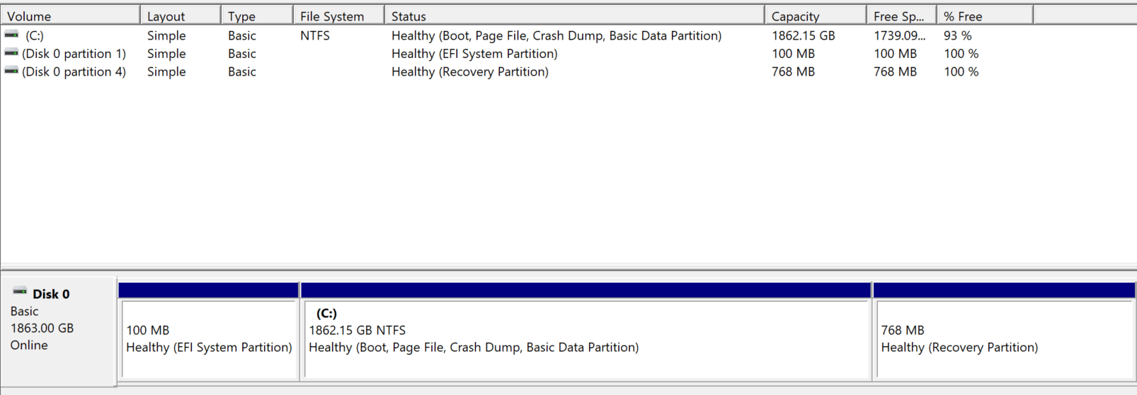

    2024-03-04T03:37:50+00:00
    This is all that shows on disk management
