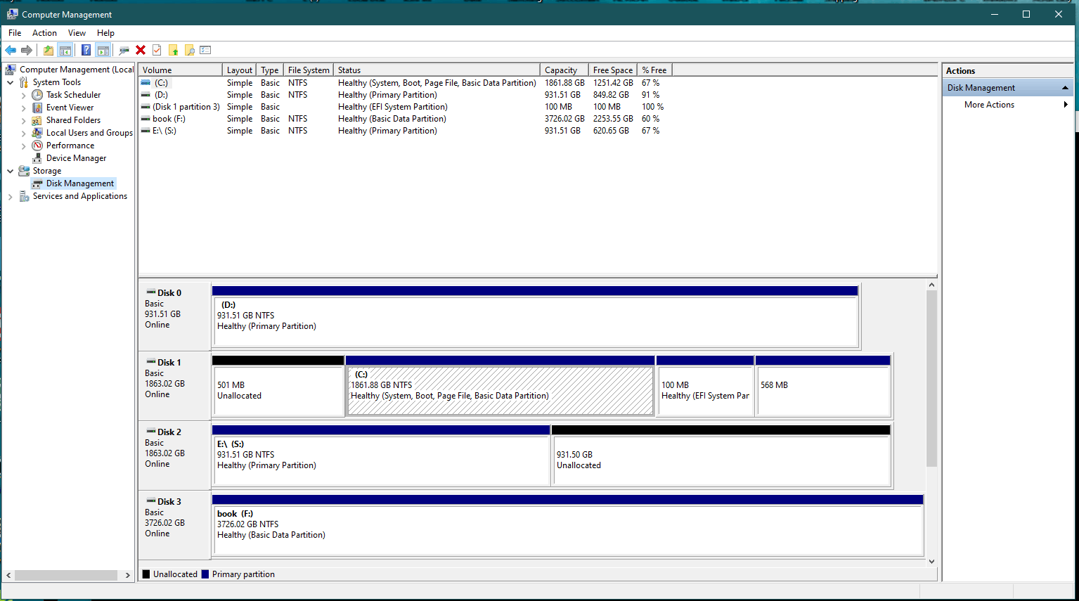

I cloned my OS drive twice to move to a newer hardware. But the last time, it seems the "System Reserved" partition of the drive had some issues.  1st: it is not showing "System Reserved" on that partition.  2nd: the following attributes "system, Active, MBR" are not on it and shows only "Primary".  My PC still boots up, but the whole purpose of this exercise was to get compatible to install Windows 11 and upgrade the OS drive with new and faster hardware.  My questions are:
Is there anything I can do to fix it other than re-installing the OS?
Is this going to cause any issue with upgrade to Windows 11?
See below properties of this partition.

  1. Ramesh 181.8K Reputation points Volunteer Moderator
    2024-07-06T16:49:19+00:00
    Thanks.
    We can do the following later (after the upgrade).
    1. Move EFI to Partition 1.
    2. Delete the existing EFI partition
    3. Shrink C drive by 80 MB
    4. Create a Recovery partition in the unallocated space and configure WinRE.

  3. Ramesh 181.8K Reputation points Volunteer Moderator
    2024-07-06T16:44:42+00:00
    Givi,
    WinRE is now located in the OS partition, even though a dedicated recovery partition exists. This happened because the recovery partition does not have sufficient free disk space. The partition size needs to be 750 MB or more.
    Anyway, we can fix that anytime later. Let me know how the Windows 11 upgrade goes.
