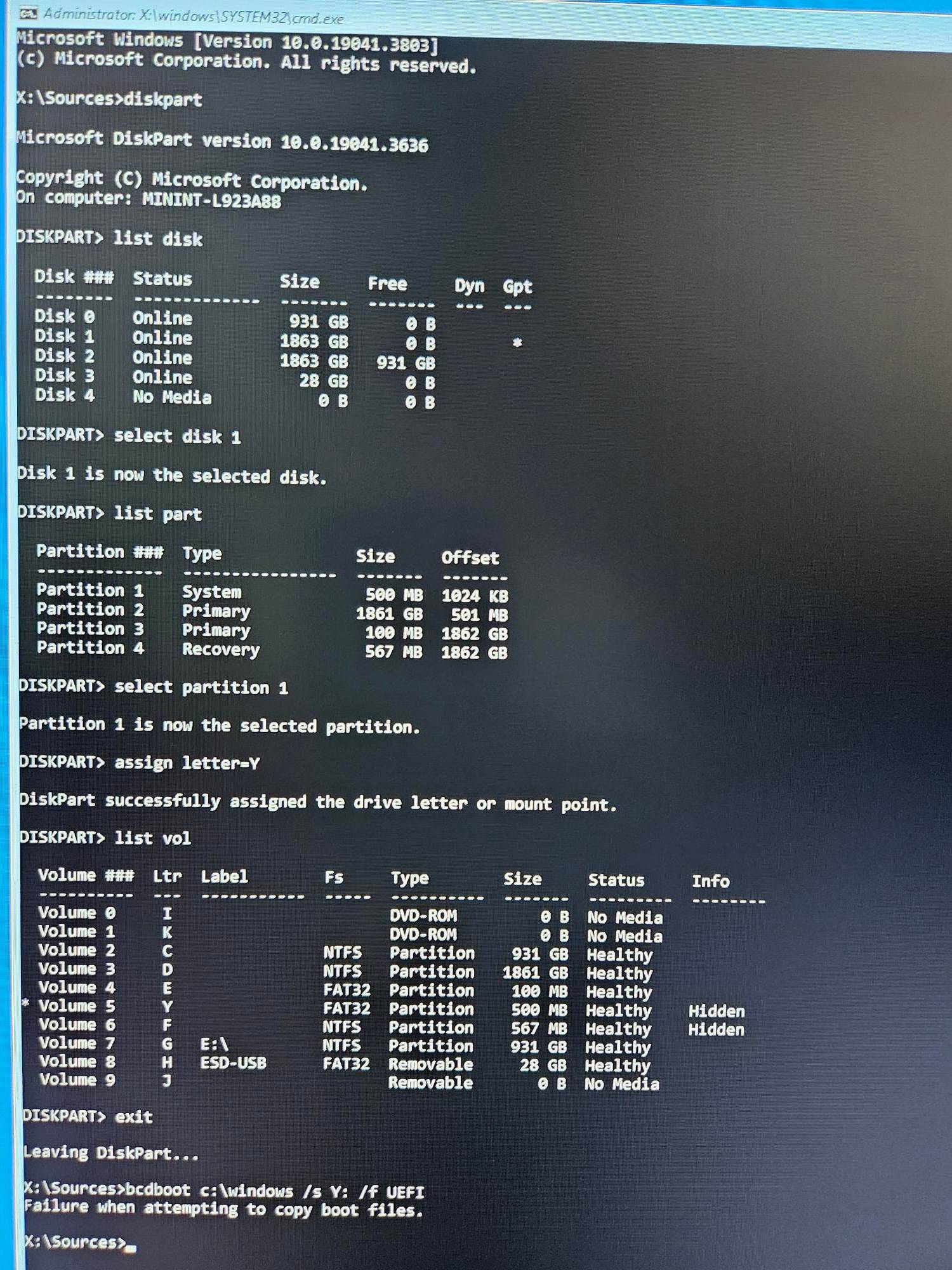

I cloned my OS drive twice to move to a newer hardware. But the last time, it seems the "System Reserved" partition of the drive had some issues. 1st: it is not showing "System Reserved" on that partition. 2nd: the following attributes "system, Active, MBR" are not on it and shows only "Primary". My PC still boots up, but the whole purpose of this exercise was to get compatible to install Windows 11 and upgrade the OS drive with new and faster hardware. My questions are:
Is there anything I can do to fix it other than re-installing the OS?
Is this going to cause any issue with upgrade to Windows 11?
See below properties of this partition.

Givi,
We can remove H: after verifying the configuration of the new EFI partition.
Hi Ramesh,,
OK. Can we get rid of the "H:" drive before I proceed doing the above commands? Also, what about the 568MB unallocated partition, should we remove that or add it to the partition-1?
Thank you,
Givi
Please be very careful when you're in the diskpart environment or working with partitions. A typo can cost your entire data.
From Windows admin Command Prompt, run:
Run:
Restart Windows and run:
Post the output.
// Also, I am not sure why the 100MB partition 3 is now labeled as the "H" drive ! //
You don't need two EFI partitions. So we've converted it to a basic data partition.
