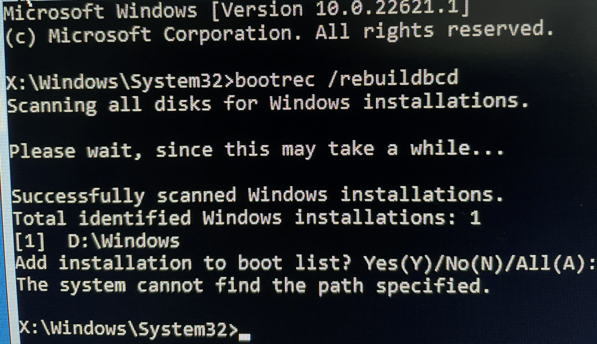

    2024-07-17T15:55:53+00:00
    Hi Remesh,
    This was result ?
    D:\ !!!!!?????
    This is reality:-
    C:\ is MSI and F:\ is USB.. Where did D:\ come from ??? and only one installation found ??
  2. Ramesh 181.2K Reputation points Volunteer Moderator
    2024-07-17T15:17:23+00:00
    //Boot Manager only showing one boot device.//
    With the external drive connected, please try bootrec /rebuildbcd from WinRE. It should add the external drive to the BCD/boot menu. Reboot the system to test if the boot options are working.
    Once done, clone the EFI (from MSI → Samsung) so that both disks have identical configurations.
