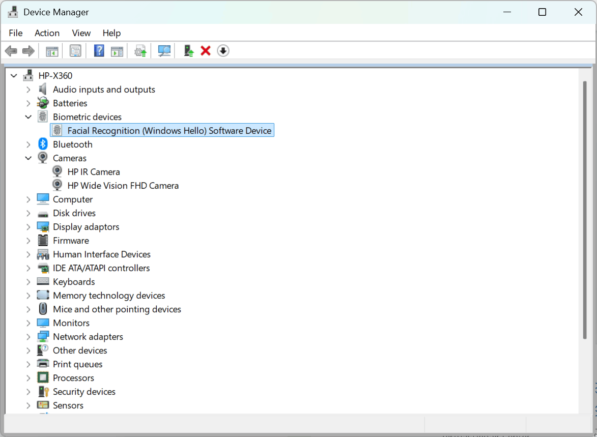

Have checked for corrupted files (none found), deleted the Facial Recognition (Windows Hello) Software Device in Device Manager & Rebooted.

To add to this thread, after having absolutely no problems with Windows Hello Face Recognition, I have just updated to 24H2 , and Hello Face Recognition immediately failed.
I have removed and rescanned the hardware.
I have re-downloaded and installed the 2018 drivers from HP.
I have rebooted several times.Nothing works, although it should be noted that if I use the Windows Camera application, 2024.2408.1.0, I get an image.
If I attempt(ed) to Improve Face Recognition, I was asked for confirm my PIN, but then it 'failed to start camera'
Someone mentioned a theory about the Hello data being corrupt, so I thought I good idea to remove Face Recognition and start again ... now if I go into Sign-in options, I am informed 'This option is currently unavailable'
Given the evidence, it would appear that 24H2 breaks the relationship between Hello and the IR drivers. Perhaps the Biometric device driver is at fault?
