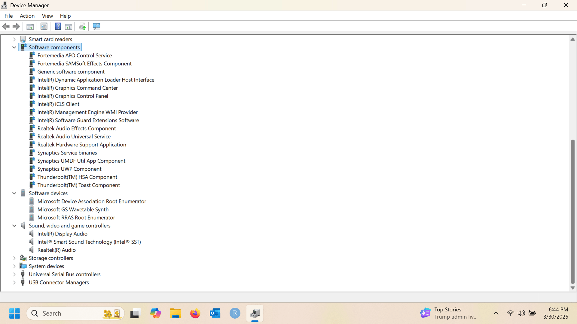

    NOTICE WRITING IN CAPS SO YOU'ALL WILL SEE IT: AS A COMPUTER SOFTWARE & HARDWARE PERSON I WANT TO SAY HOW I FIXED THIS ISSUE ON BOTH OF MY LENOVO THINPAD T14 LAPTOPS. I WENT INTO DEVICE MANAGER AND WENT TO SOFTWARE COMPONENTS AND FOUND SOMETHING CALLED DOLBY SOMETHING. I UNINSTALLED IT, RESTARTED MY COMPUTER, DID AN UPDATE AND IT NEVER SHOWED THIS UPDATE AGAIN. I ALSO SAW THAT IT HAD BE DOWNLOADED BEFORE A FEW TIMES. THIS FIXED IT ON BOTH THINKPADS. SHOWHIDE SOFTWARE DID NOT WORK BECAUSE IT DID NOT SHOW THE DOLBY SOFTWARE SO I COULD NOT HIDE IT. ANYHOW GIVE IT A TRY. IT DID NOT COME BACK INTO MY DEVICE MANAGER WHEN I HIT, 'SCAN FOR HARDWARE CHANGES' EITHER.
