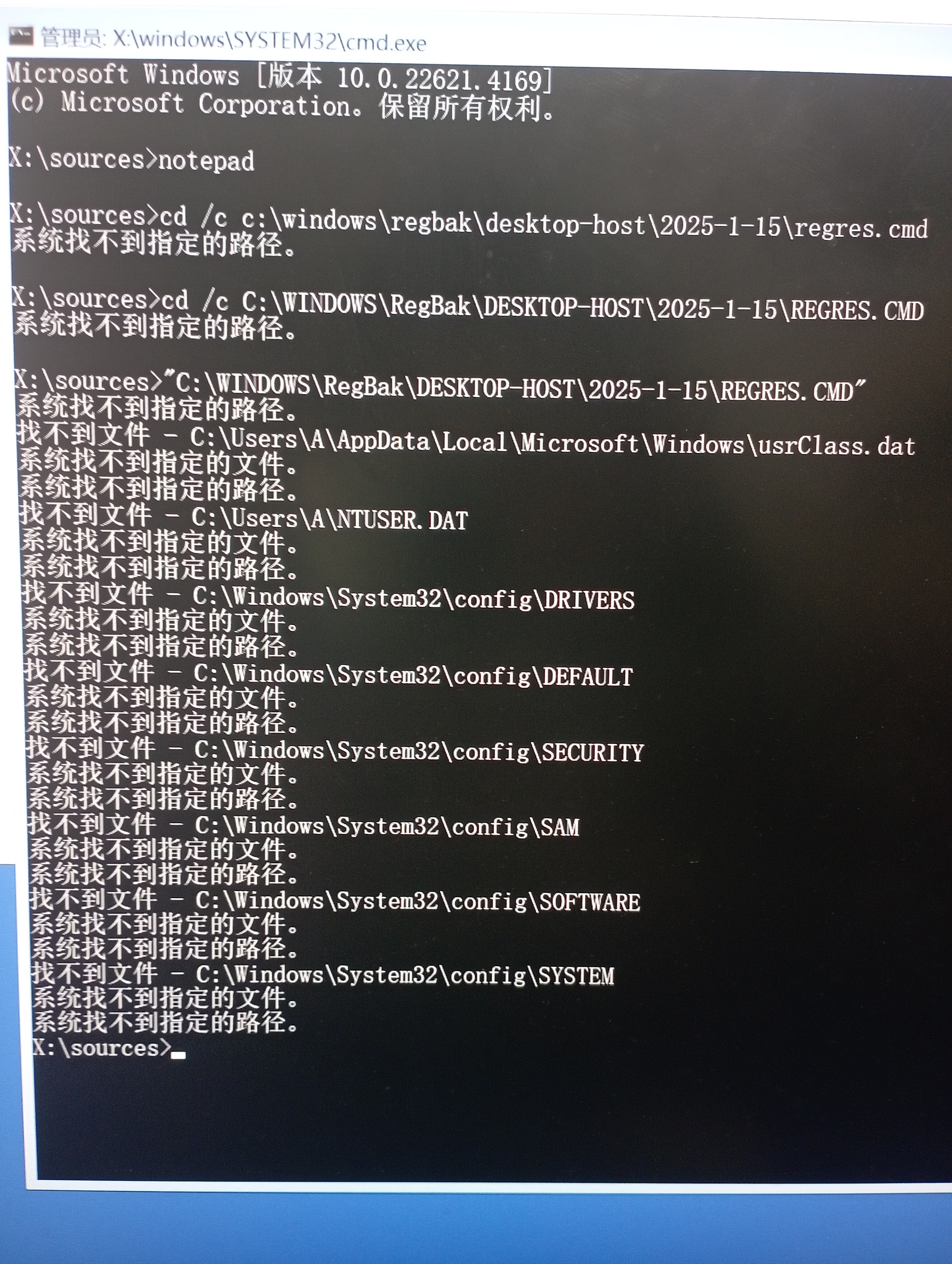

    2025-01-16T08:19:30+00:00
    So something is missing here?

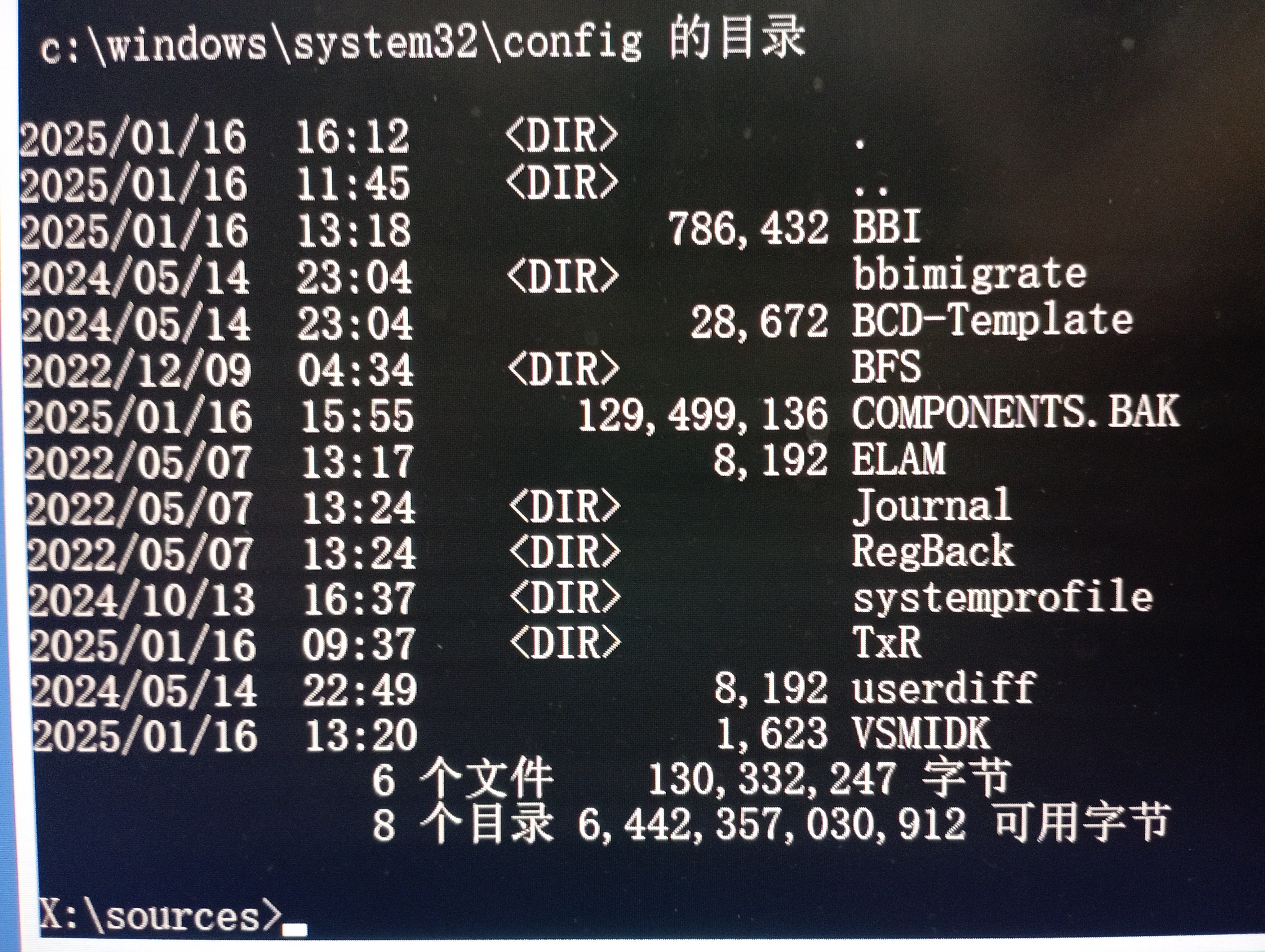

  2. Ramesh Srinivasan 87,610 Reputation points Independent Advisor
    2025-01-16T08:16:57+00:00
    Run:
    bcdedit | find "osdevice"
    dir c:\windows\system32\config\
    Post the output.
    2025-01-16T08:15:28+00:00
    Yes, this is after I ran it.
    2025-01-16T08:14:31+00:00
    It says it can't find the file/path
