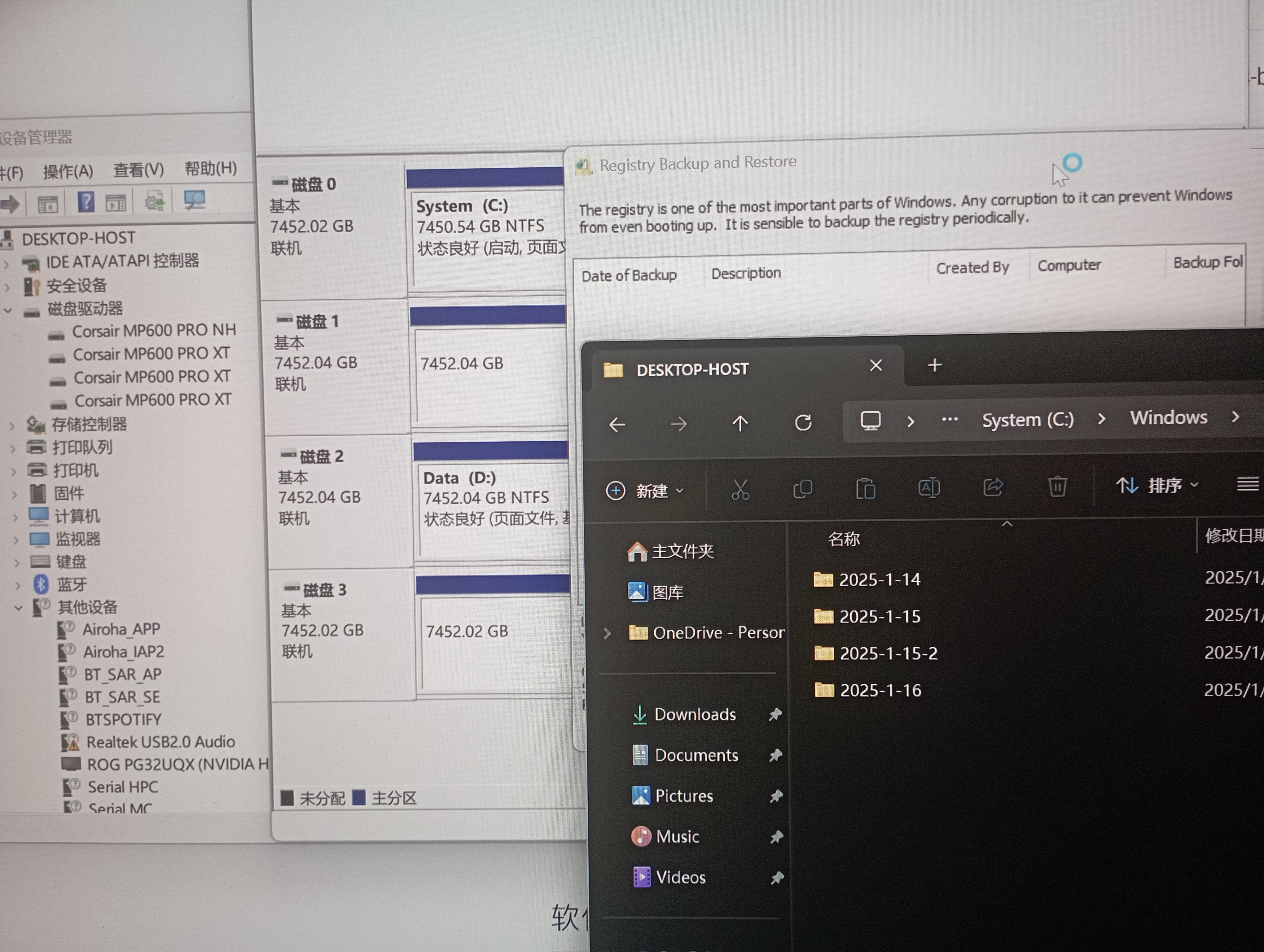

  1. Ramesh Srinivasan 87,615 Reputation points Independent Advisor
    2025-01-16T03:09:24+00:00
    The last Fixlist would have created a Restore Point. Please see if you can rollback to that point.
    Alternatively, you can restore the registry via WinRE.
    Once inside WinRE, run the "REGRES.CMD" file to restore the registry from that backup.
    2025-01-16T03:01:19+00:00
    Unfortunately no, as it'll just says"The operation cannot be completed because the disk console view is not up to date".
  3. Ramesh Srinivasan 87,615 Reputation points Independent Advisor
    2025-01-16T02:56:50+00:00
    If they show up in Disk Management, can you manually assign drive letters to the drive partitions?
    2025-01-16T01:57:11+00:00
    OK, bad news. I just rebooted the system and only 2 of the 4 SSDs showed up.
    They all show up in the BIOS and Device Manager, but no drive letters are assigned to them in Disk Management, and they don't show up in File Explorer.
    I tried reinstalling the chipset drivers, to no avail.
    Also tried moving them to different M.2 slots - C and D drives always show up, while A and B never do.
    Also, I can't find any backups in RegBack now, although the files are still there.
