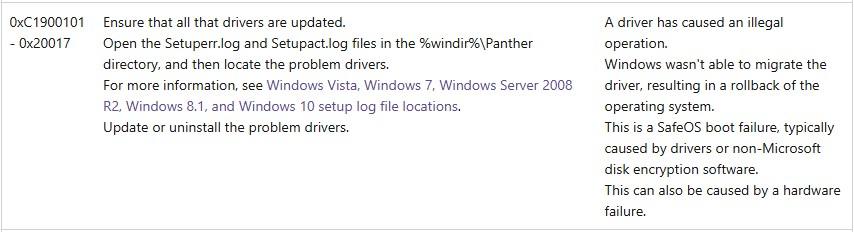

    Here's the official fix for the 0xc1900101 - 0x20017 error.
    https://learn.microsoft.com/en-us/troubleshoot/...
