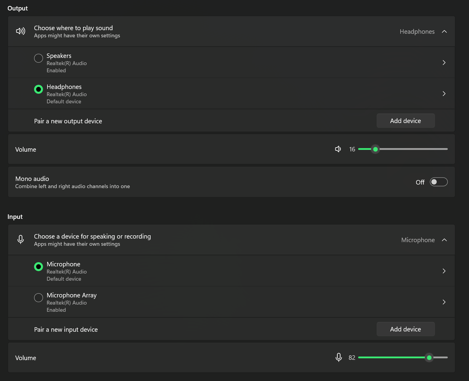

    2025-02-25T15:52:01+00:00
    Sure, here you go! Note that neither the microphone nor built-in microphone array are working, nor are the wired headphones without disabling audio enhancements first. I also contacted Lenovo Support, did a system restore, reinstalled all audio drivers, did a Windows 11 repair install, and nothing has fixed it. Unfortunately, the next step Lenovo Support suggested is the go-to factory reset option, which I'm just not prepared to do at this point after all the other troubleshooting time and energy I've expended trying to solve this.
