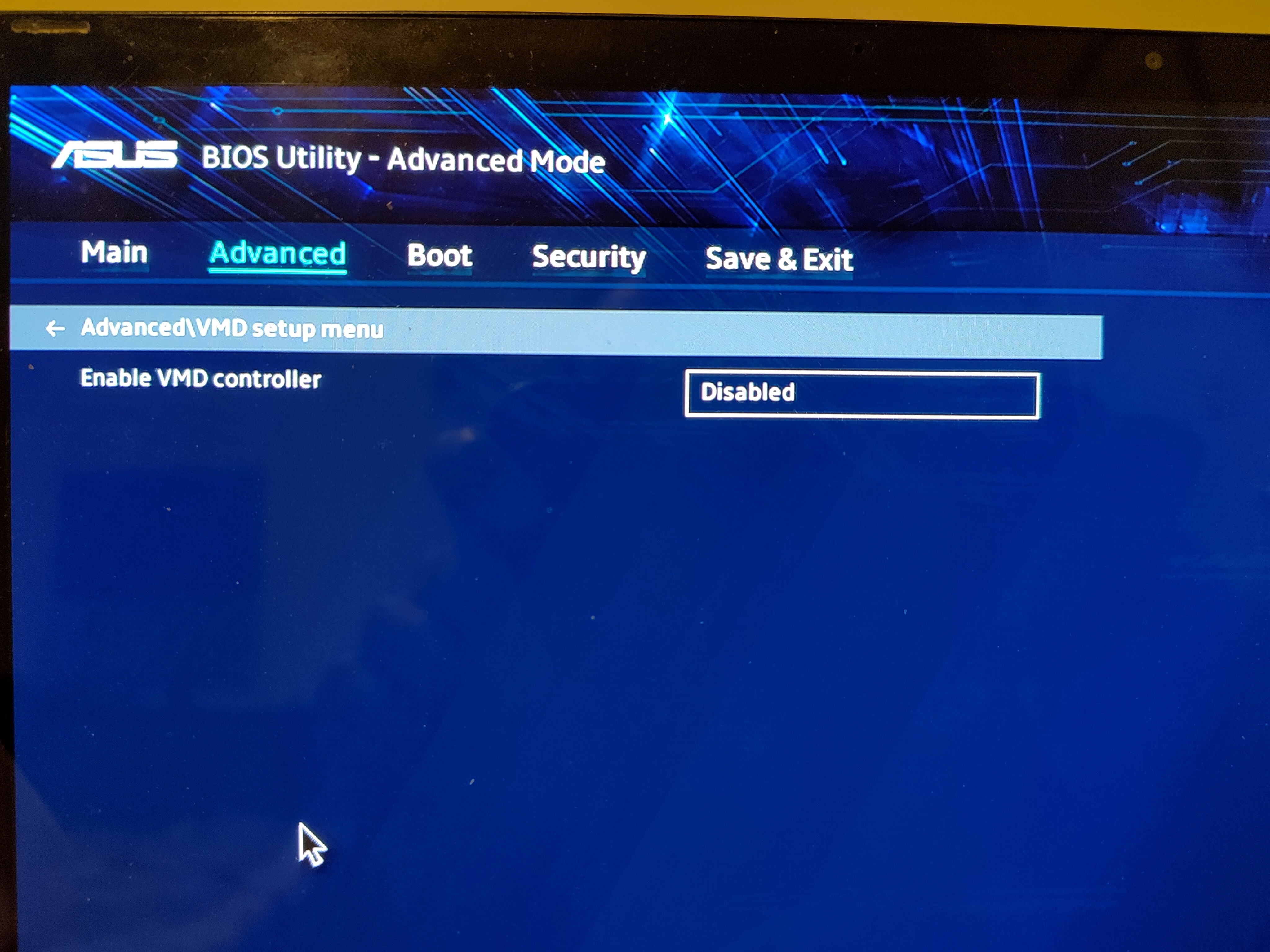

I have some great news; after some searching, I found out how to disable VMD on my computer and switch it from RAID to AHCI. I had to set the computer to Safe Boot before going into the BIOS to disable the VMD controller mode. When it booted up, it automatically installed a AHCI driver in place of the VMD-based driver that was controlling the storage drive, after which I disabled safe boot and it booted up normally. This was the guide I ended up following: https://superuser.com/a/1359471
The Windows 10 in-place upgrade went without a hitch, and so did the Windows 11 upgrade! The VMD controller turned out to be the culprit behind the boot drive not being detected during installation. Thanks so much for helping me out!
