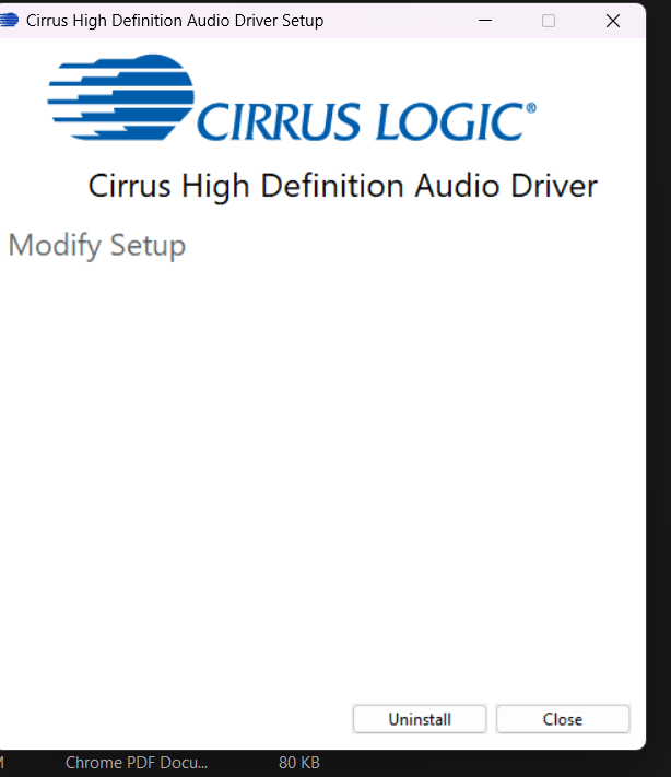

I searched up common issues and solutions, such as going to device manager and uninstalling the device, restarting the computer, and re-plugging the device(didn't work), and it was suggested maybe the port(3.5mm jack) was the issue, so I bought an adapter to plug into a usb-a slot and still only came up as an output. Then I tried reinstalling the RealTek driver but couldn't find any RealTek drivers available.
My only guess as to the cause of this is a previous Windows update(as there have been quite a lot in the past few months) deleted a required driver, but now I can't even find the driver needed. I'm also struggling to find previous updates/drivers.

    Does it have to do with the fact the realtek driver from the link earlier isn't compatible with this system?

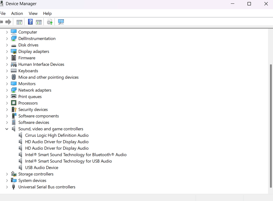

  2. Ivan B 124.1K Reputation points Independent Advisor
    2025-06-02T05:37:07+00:00
    Hi ,
    Strange, yours should recognize Realtek.
    Access device manager > sound, video and game controllers. Take a screenshot and post it here.

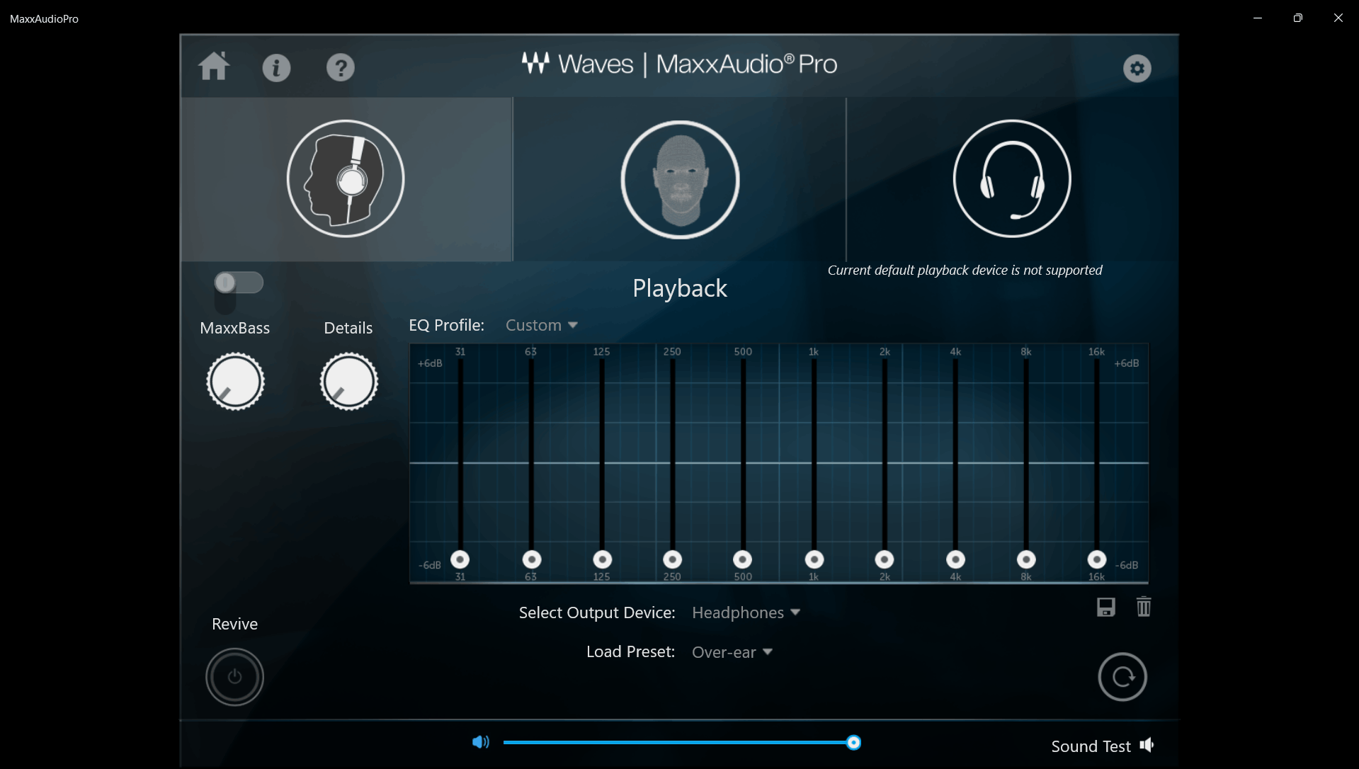

    2025-06-02T05:34:17+00:00
    Why is yours lit up like that?
    Mine is, if I had to describe it dull, and I can't adjust anything. Does it have something to do with the "current default playback device is not supported"?
  4. Ivan B 124.1K Reputation points Independent Advisor
    2025-06-02T05:29:28+00:00
    Hi ,
    If yours doesn't work, the Realtek console, what works is Wavemax, it has to open and there will be an option to select output device and you can select the type of input, which should be speakers or headset.
