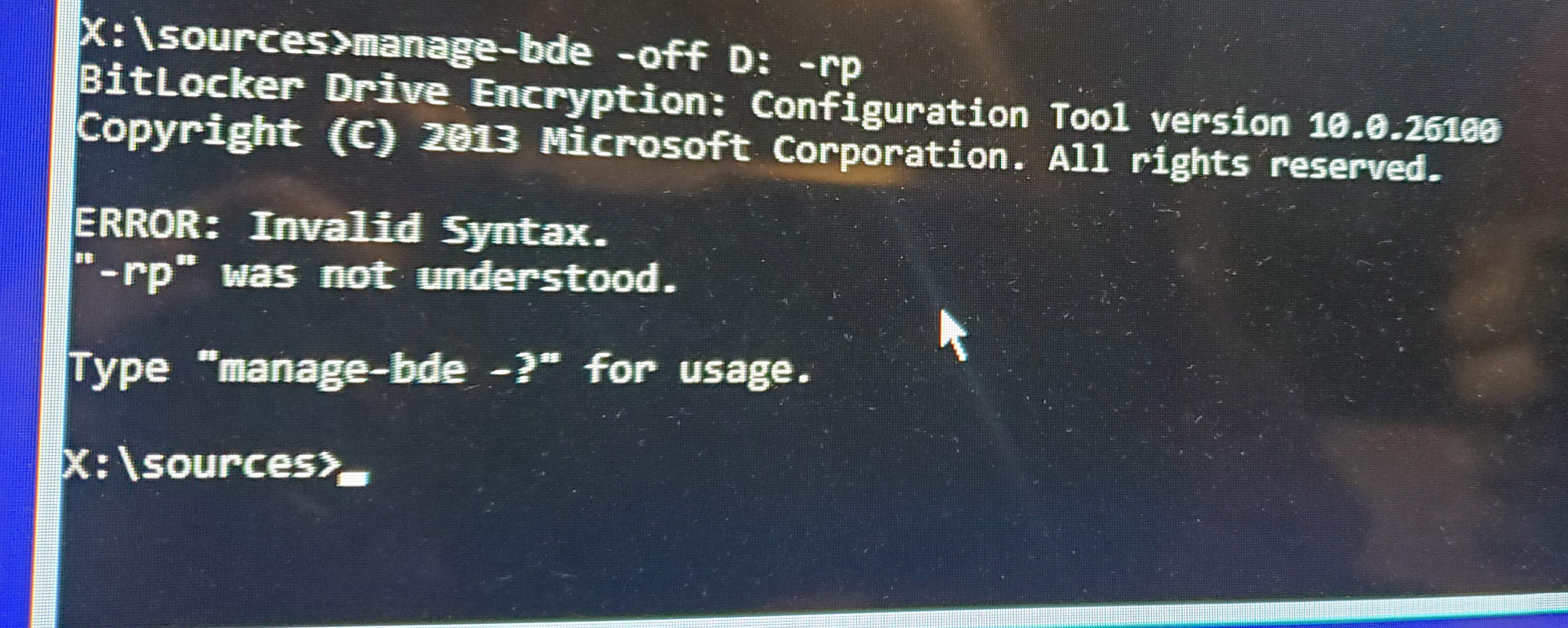

    2025-04-27T18:59:50+00:00
    That's what I put (see the top of the photo I posted). It says "ERROR: Invalid Syntax. "-rp" was not understood. Is there supposed to be something like a number in the example you gave after "-rp"?
  3. Manoel Barros 22,030 Reputation points Independent Advisor
    2025-04-27T18:20:57+00:00
    Sorry about that. The command was not sent in its entirety.
    manage-bde -off D: -rp <Key>
    You should replace <Key> with the Bitlocker Recovery Key.
    2025-04-27T17:00:45+00:00
    When I type in the first command line, it comes up with an error.
