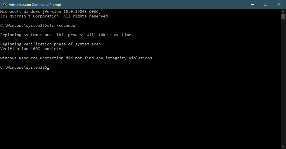

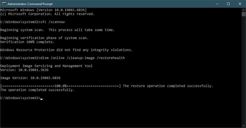

    Working on resizing the partition and I'll uninstall razer drivers/programs as soon as I'm ready to attempt another win11 install (my mouse and keyboard are Razer so they are going to auto install drivers as soon as I plug them back in.)
    I uninstalled Corsair and CCleaner.
    Below are the sfc scan and the dism cleanup/restore
    https://learn-attachment.microsoft.com/api/attachments/19cd26a5-7de3-4ddc-9231-dbcdb85647eb?platform=QnA&fud_access=hC1SxZhn7m%2FZQJkOIiOVstu10yTQgXS4A%2FDBzZTg8nbaCgIogkrcDydMeI5Y4za2dOqDdWtsG2JNS3E35V60i9TiGHR7STMpJHheeXuDvO8nwjUlqCBHhJ0NDvuYN7OSiBxlSR5jm0O8Q4vFODKySwlEyi%2BIpia6IXoZgzZaiPfop5%2BjfZxU4K4nZjbfPHqEkfEJis7bnqPVeBm8lZmHRBrKLXHw35NSmGuXprPmBTnxS96IDtJ4HimVZkCYYjION9W9tjRZ1aDIbKGEH3fxmQEJDTOiobWqpHeAnVAvkNmDOTKQ0gXbHL7PJwd1hOx46TKz3g2n3d%2BU7brkkZNfZZ2YoQR6S5h8iBcZkgxkQLUlYhvJorh65WG5sIK%2BmtZxS2ZvTCu0vFkRdiPwmVj9Z5jFHmokABOY3JOp4ym440A%3DImage
