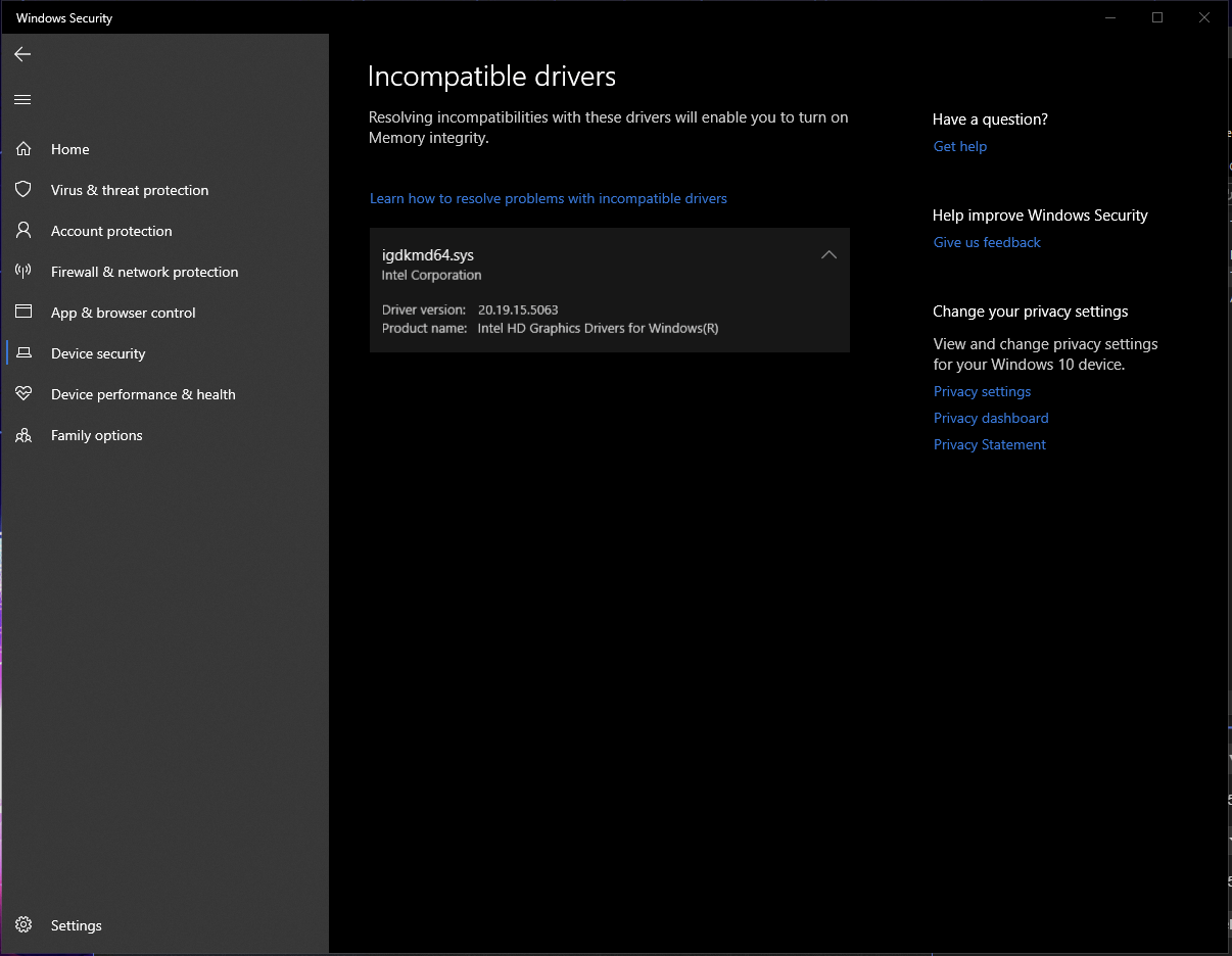

    Tried to turn on Memory Integrity but there is an Intel HD Graphics Driver stopping it. I'm not sure where to go to delete that since it's not showing in my device manager though.
