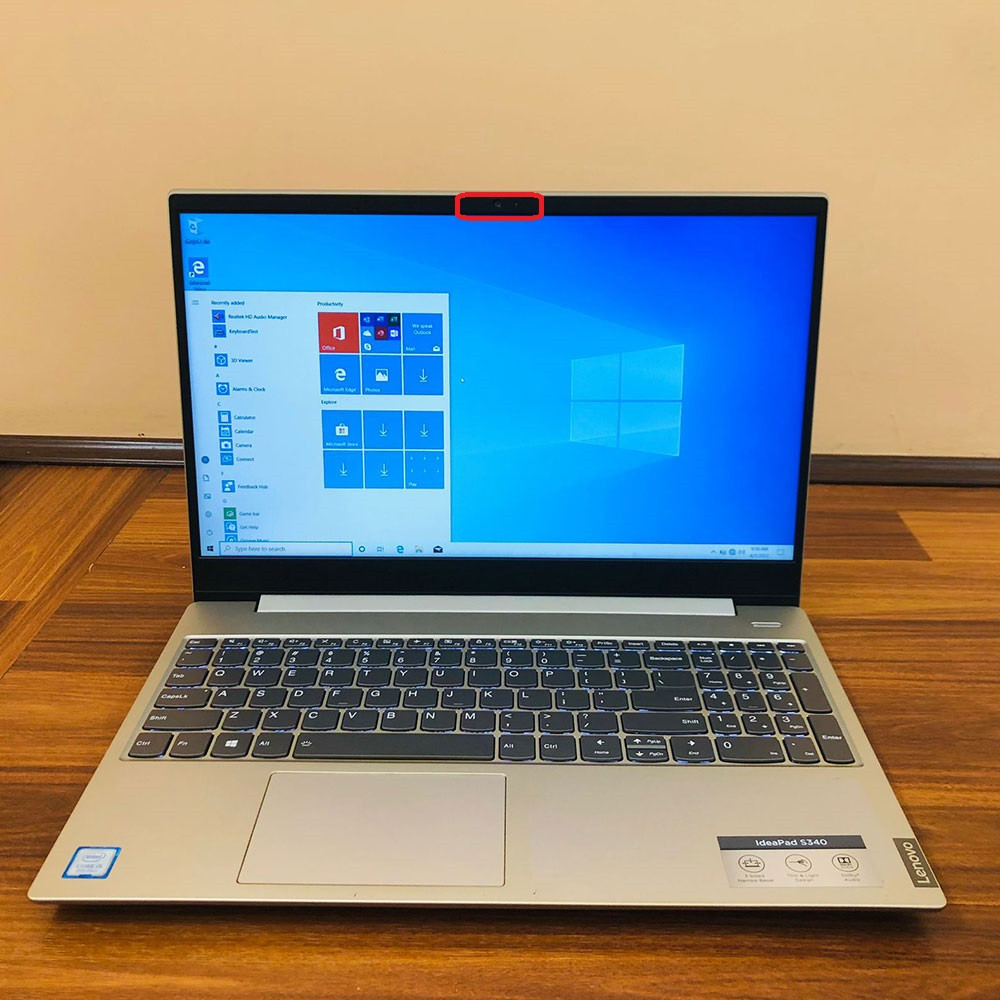

    Yes, agree with your suggestions and discovery; pinch (gently), the bezel from the outside and inside (around the camera). The distortion disappears and camera is working again.
    It could be a hardware issue; eg. wire connector, etc; not software problem, especially when Windows 11 Device Manager shows webcam is working.
    I encountered this issue since Year 2022 after every Windows 11 update.

    2024-02-08T05:32:53+00:00
    There are feedbacks on (1.1) Lenovo's website from consumers, and (1.2) Microsoft community, on above problem. 1 possible solution from Microsoft's community, and Lenovo's website, is about "Pinching" or "lightly pressing with thumb and finger" on screen frame (bezel) area around the webcam.
    It could be a hardware issue; eg. wire connector, etc; not software problem, especially when Device Manager shows webcam is still working.
    I did as suggested, and solved my webcam problem, which caused no video after every Windows 11 update. I encountered this issue since Year 2022, for almost every Windows 11 update.
    I attached a picture as reference; take note red colour rectangular box around webcam. This is the area to "pinch".
    Note :
    • I download a Lenovo notebook picture online while writing above.
