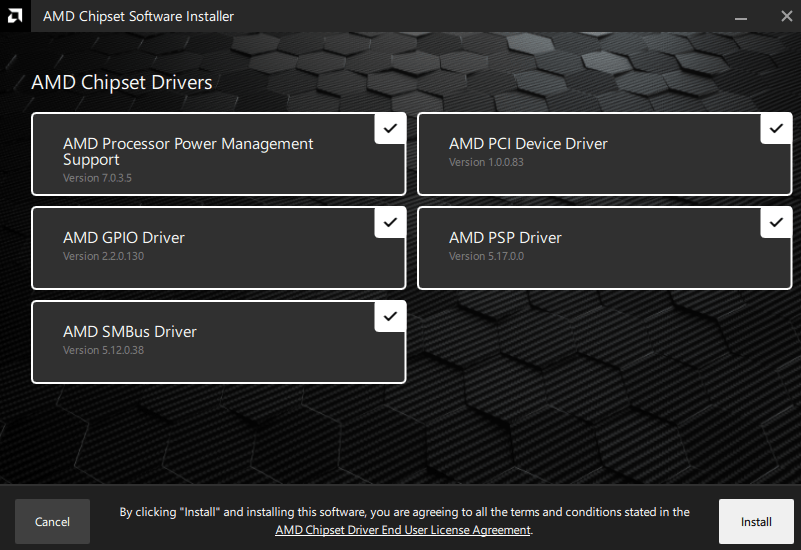

    I have also tried Windows Sandbox and the Task Manager in it works ok. However I was able, last evening, to improve the speed of my Task Manager by updating my AMD drivers using the auto-detect tool at https://www.amd.com/en/support
    Mouse lag when sorting the columns is gone, and time to sort is down to ~2 seconds from 5+.
    However I still have mouse lag when opening the Task Manager the first time after a reboot.
    The drivers I had to update were:
    Windows Update still shows I have the following outdated drivers, which I'll try to update:
