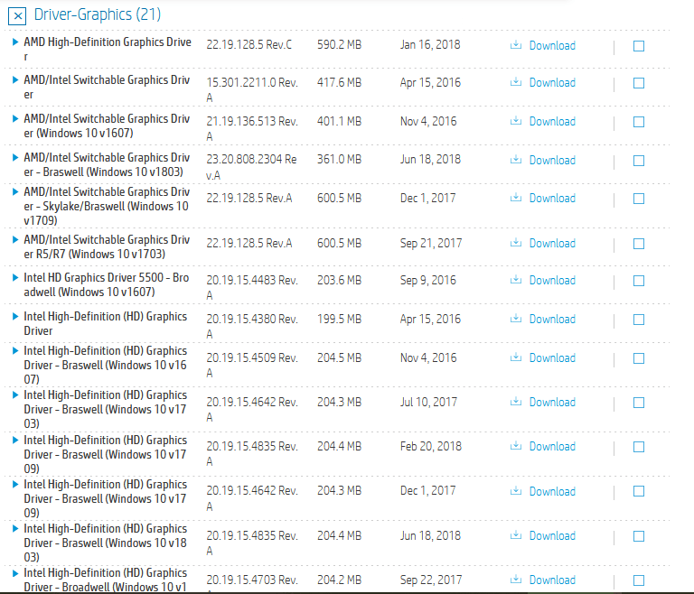

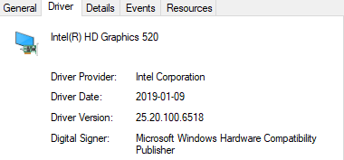

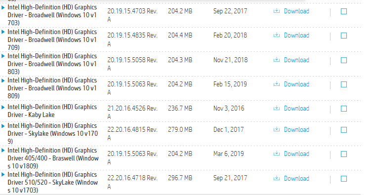

    Now step #4 Update Graphics driver closely matches the suggestion from you as well. However, I am unable to determine going through the drivers listed at https://support.hp.com/ca-en/drivers/selfservice/hp-15-ay000-notebook-pc-series-touch/10862302/model/13443443?sku=X6V89UA and my Device Manager, which one I should download.
    This is from my Device Manager:
    This is the list from HP's website for my laptop model and serial number:
    Now, this is only the graphics driver and I haven't even looked at other drivers you suggested and those flagged by error log.
    I am at my wit's end and even considering a reset. But worried if I reset, and Windows still uses the same drivers will this issue persist?
