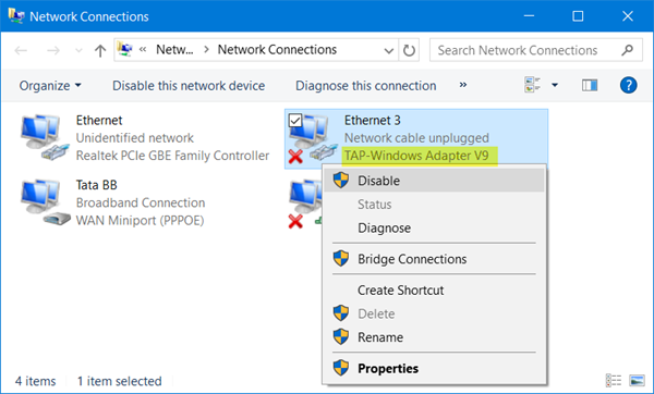

    2020-06-29T18:19:32+00:00
    If that still didn't work, can you experiment on changing your default browser to chrome or firefox,
    • Press Windows + R type control then enter
    • Click on "Programs" > "Default Programs" > "Set your default Programs"
    then select the browser that you want to set as default. if it still doesn't work
    • Right-click on the wifi icon or ethernet icon on the taskbar
    • Click on "open network and internet settings"
    • On the right pane, click on "Change network Adapter"
    • a list of your network adapter will show then Disable the "Tap Windows Adapter" if you have any
    see the attached picture
