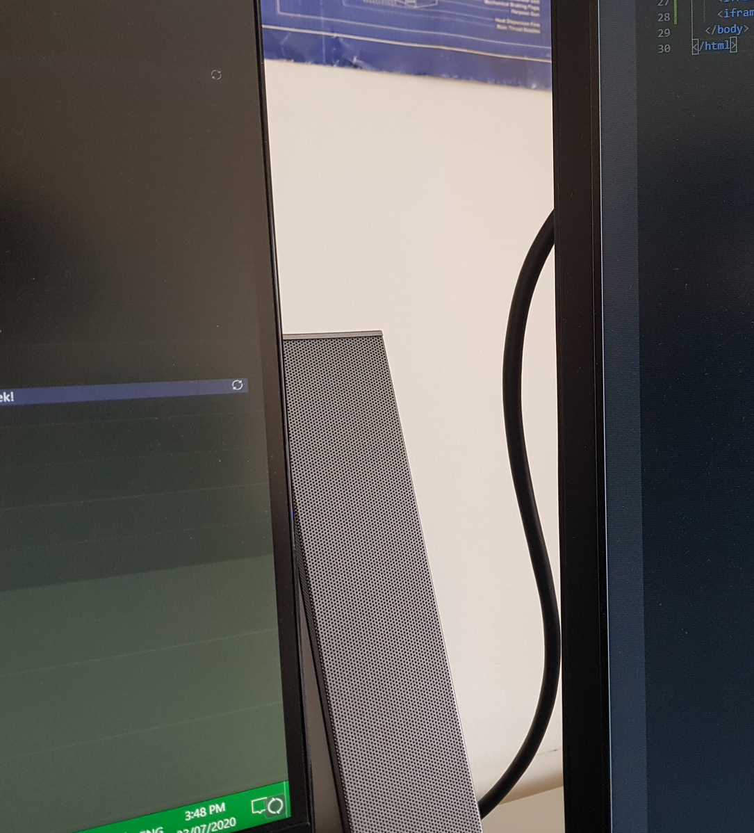

Hi all,
A month or so ago I updated my windows 10 and noticed when I was focused on a window on one monitor it would bleed over onto the other monitor. I waited for the next windows 10 update to see if that would fix the issue, I updated my windows 10 version last week, but it did not fix my issue. Does anyone know how to stop the focused window from bleeding onto the second monitor?
I have posted a picture below that demonstrates the issue I am having.

    I got it to happen with Microsoft teams too. You can see the thin white line on the left hand side of my vertical monitor.
